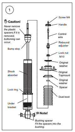

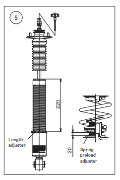

                        What is the purpose of this ring on the rear shocks of the Ohlins Road and Track?
                        I'm trying to figure out a clunk on bumps - a mechanic seems to have messed with this ring and I'm questioning if the origin of the problem could have anything to do with it.
                        Click image for larger version  Name:	1045107_x800-167218094.jpg Views:	0 Size:	50.9 KB ID:	277466
                        All I can find in the Ohlins manual is that it's a lock ring to adjust the length, but there isn't much being said about it and how to use it properly:
                          That ring allows you to unlock the lower portion (gold) and adjust the length of the damper.
                          For the Ohlins, make sure the orientation of the rear spring has the lettering facing out of the wheel well.
                            Ok! The mechanic I brought it to extended it well beyond (about 2cm) the caution mark. I suspect this is the cause of the noise. I found from the Ohlins manual that "The bracket shall not be adjusted below the caution line as it may come loose or break." I am currently thinking about what that means. Is "the bracket" the golden thing? So if mine were loose or broken it would be obvious? Or should I suspect something internal is broken?

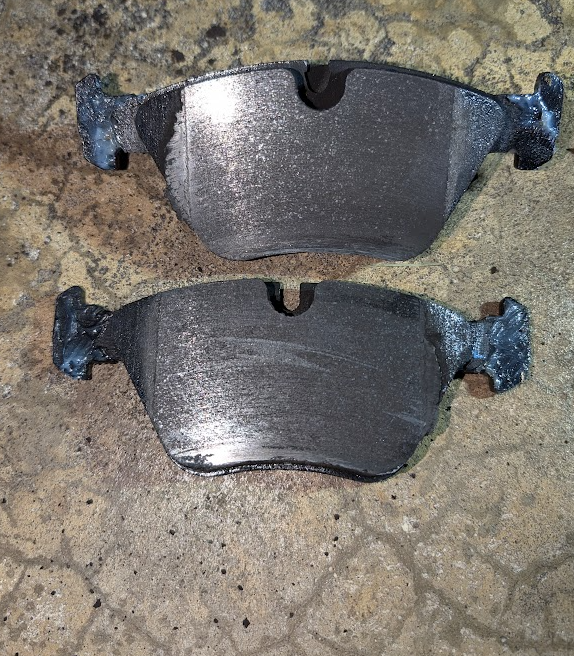

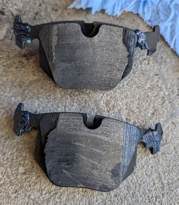

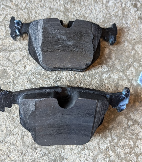

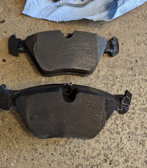

                              I'm chasing down a "pulls to the right issue". I had an alignment done last year, it's not the slant of the road, and I just changed my FCABs (not the entire control arm -- yet). I still have the issue, especially under harder braking. So next up on the suspect list is a sticky caliper. The right front wheel seems a lot hotter and smellier after short rides. I just changed the rotors and pads like 50-100 miles ago. I got the fcpeuro kit of zimmerman rotors and Textra OE pads and did all four corners. I'm picking up the rebuilt (and powder coated!) calipers this week and in prep I got the car in the air and took everything apart. Does this brake pad wear look normal? Like I said, probably only 50-100 miles on these pads, so not sure if they still need to break in or whatever - but it seemed odd to me and this is the first brake job on my m3. Looks like some of the ends are "chewed up". Attached are pictures of all four corners. Is this normal? Thanks!
                                Yep, def. sounds like a stuck caliper.
                                AFAIK, break-in is about pad material getting onto the rotor, not the pad material itself breaking in.
                                The pics on the right are from the suspect caliper, right? They look a bit glazed. Could just be the lighting.
