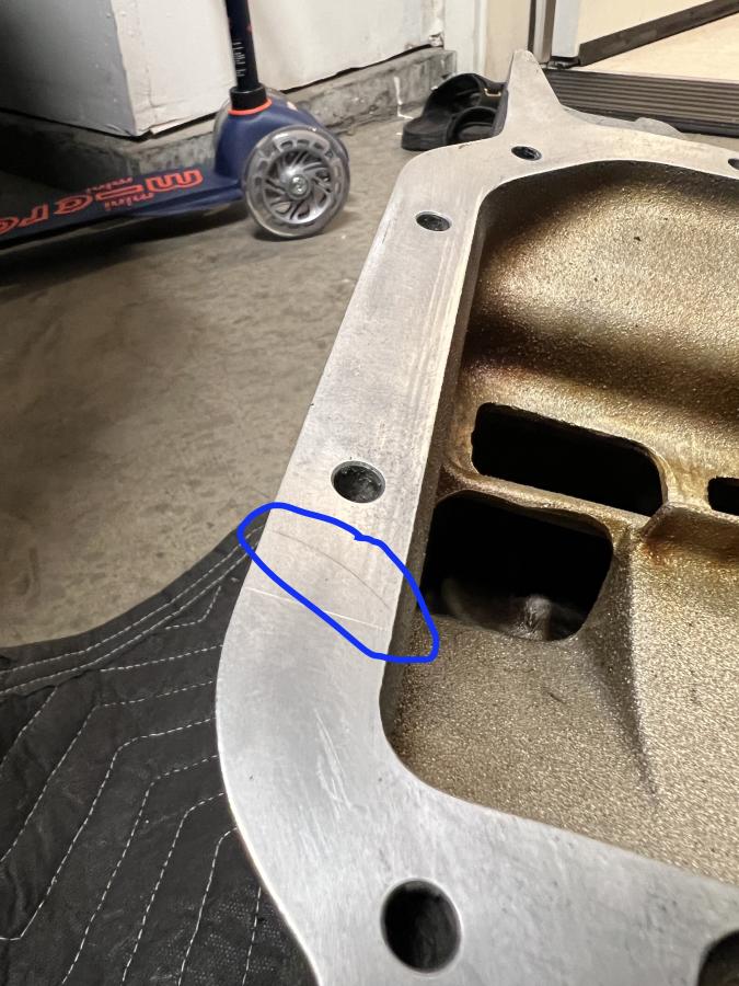

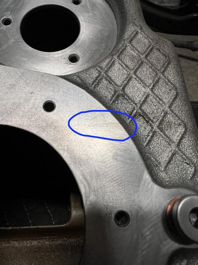

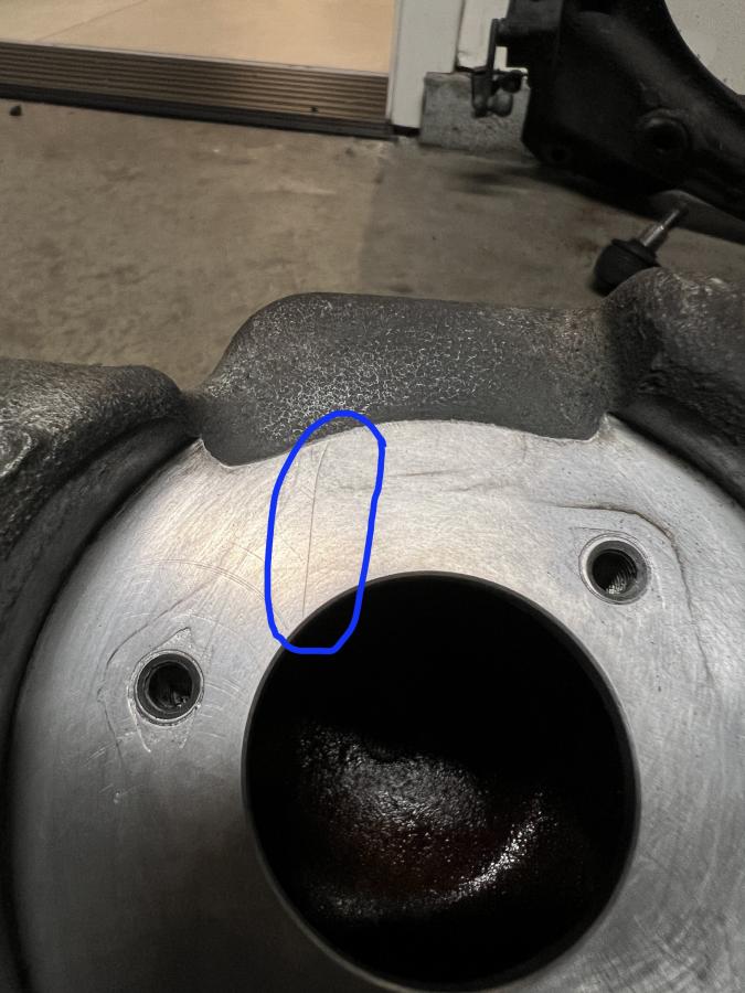

                Wondering if I should try and mess with these scratches on my oil pan, or if the gasket will handle it. I was very careful handling the pan so I believe it was from the previous owner, and I had no leaks when removed.
                What's everyone think:

                oil level sensor surface

                center cover area

                  The oil pan and level sensor gaskets are likely fine being they are fairly malleable but the filter screen gasket is metal and may not deform and fill any voids. But as you noted if it was fine before it's likely going to be fine as well. IF you are concerned about it though just give it the thinnest smear of RTV or your favorite sealant when going back together.
                  Email to [email protected]
                    noted thanks!
