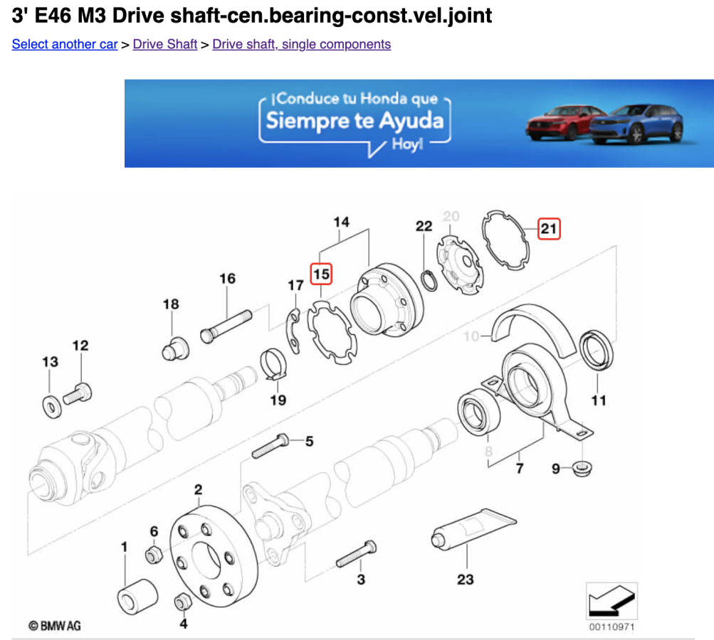

            Driveshaft CV joint, just double checking #15 on this diagram is not needed, for non M cars that have the #20 cap cover thing. #21 is needed of course

              correct
              Email to [email protected]
                correct
                Thank you kind sir
