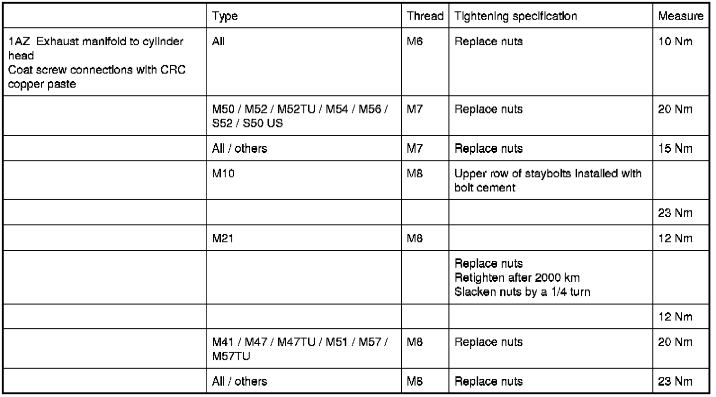

                Is this too much exhaust leak coming from the exhaust head outlets? I pulled gaskets off (they had about 6 months of use) and this was the result from banks 1, 2 and 4. Did I not tighten the nuts down enough? Maybe - was hard to torque everything down.
                  I've never seen such marks in all the dozen+ header jobs I've done, only much more minor if anything. Maybe the flanges weren't very straight either, not just loose nuts.
                    Hand tight can create an exhaust leak. To fully crush the gasket and create a good seal, it needs to be torqued down.
                    1/4" Torque wrench and a small extension can get all the bolts from the top.
                    Click image for larger version  Name:	309139117.png Views:	0 Size:	89.9 KB ID:	323760

                        What is the exhaust manifold stud torque spec? Was contemplating the extended N54 bolts, but couldn’t find the torque setting in that giant torque spec PDF.
                          The torque on the stud isnt probably very high, it will be the torque on the nut that applies the clamping force to the head. Even if the stud was threaded in hand tight, it would still provide adequate clamping force.
                            On a side note, if you are using SSV1's I would skip the n54 studs, they are much longer and make lining up the header flanges a pain as they get crammed between the now longer studs/frame rail area.
                            I got my SSV1'S just after they had some bad batches with misaligned flanges, mine seemed to be straight but maybe not completely so maybe that was my hangup. I actually had to ever so slightly enlarge a few of the flange holes to get them to install
                            Euro headers etc. should be no problem.
                            Also, I feel bad that I put N54 parts on my S54, yuck.
