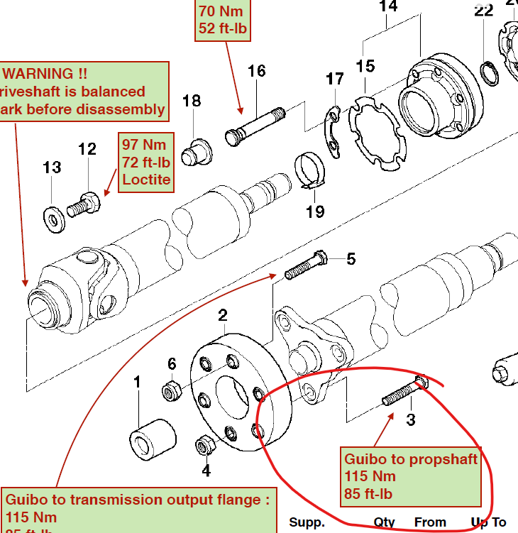

      I've seen the torque spec for driveshaft to giubo listed as 44 ft-lbs for 10.9 bolt and 74 ft-lbs for 12.9 bolt. However, our torque spec document says 85 ft-lbs, period.
      I'm assuming 44 is correct (I have the 10.9 bold)? Just seems low.
      Click image for larger version  Name:	Screenshot 2026-08-23 120222.png Views:	0 Size:	83.8 KB ID:	364697
        Spec shown on TIS:
        1AZ Flexible disc to Drive shaft and transmission output flange
        Steel Drive shaft
        E39 (M5) / E36 (M3) / E46 (M3), M12 10.9 115 Nm
