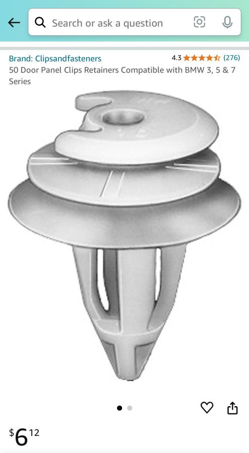

    Thanks, yea they would just not quite fit, then you pound on the panel a bit and they break.
    If you haven’t already, give these a try. The plastic seems to be a little bit thicker/stronger than the older style. They also include a foam ring which helps with rattling and improved sealing. I covered this a bit in my build thread if you’re interested.
    51418224768

                  I hate to even make a post like this, but is there a generic door panel clip that actually holds properly and long term? I bought some on Amazon and I swear I have broken more than have held, trying to put my interior back together.

                  When you have to remove the door panels to repair delamination, a broken cable, or to gain access to the window regulators you invariably damage several of the door panel mounting pins. Additionally the OEM door panel pins used on the E34 and E36 don't come with a cushioning pad like the later model
