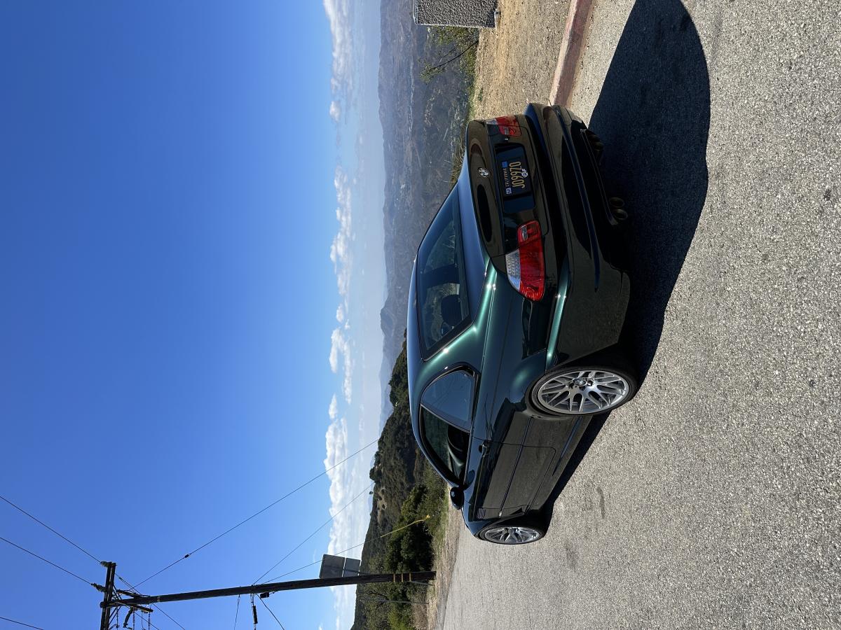

              And just so I can post a [sideways] picture of my car - you can do 275/30 with 15mm spacers in the rear if you are willing to shave your fenders…..

                If my car ever needs major paint work, I'm going full out and redoing the entire thing in oxford green. Such a great looking color.
                  Same same.
                    …it pretty much looks black most of the time, unless you get a shot of direct lighting
                      That's why I like it!
                        And we're in Socal Raj, so the OG, like my jerez, gets to pop a lot.

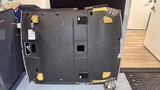

                          Is this a euro headliner or US? Need a quick dummy check

                            US. Euro ones don't have that bump in the middle.
                              Thought so, man these things are hard to find.
                              '01 M3, Imola/black
                                They really are. I ended up settling for a US one. Figured it's easy to swap a euro one in if I come across one in the future.
