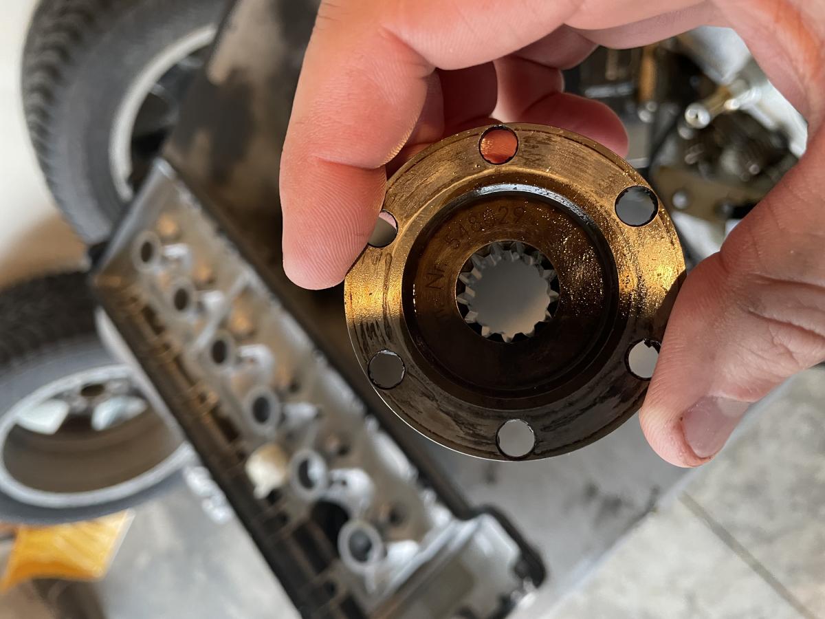

          Is there a particular orientation that these splined sleeves should go in relative to the camshaft?

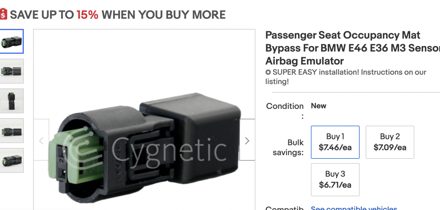

            When installing aftermarket seats and the airbag light illuminates....
            Does adding a passenger seat occupancy bypass allow the airbag to work properly or just turn off the dashboard light?
            The way this is described in the ebay listing is unclear to me.
            Thank you!
            Click image for larger version  Name:	Screen Shot 2022-03-31 at 9.54.31 AM.png Views:	0 Size:	524.5 KB ID:	161259
              The airbag light would come on if you left the battery connected while unplugging things.
              This emulator will tell the car that someone is sitting in the seat so the airbag will go off in an accident (whether there is a person in the seat or not).
              If no emulator, the airbag wouldn't go off if even if someone was sitting in the seat.
              Your aftermarket seats can't tell the car whether someone is sitting there or not.
