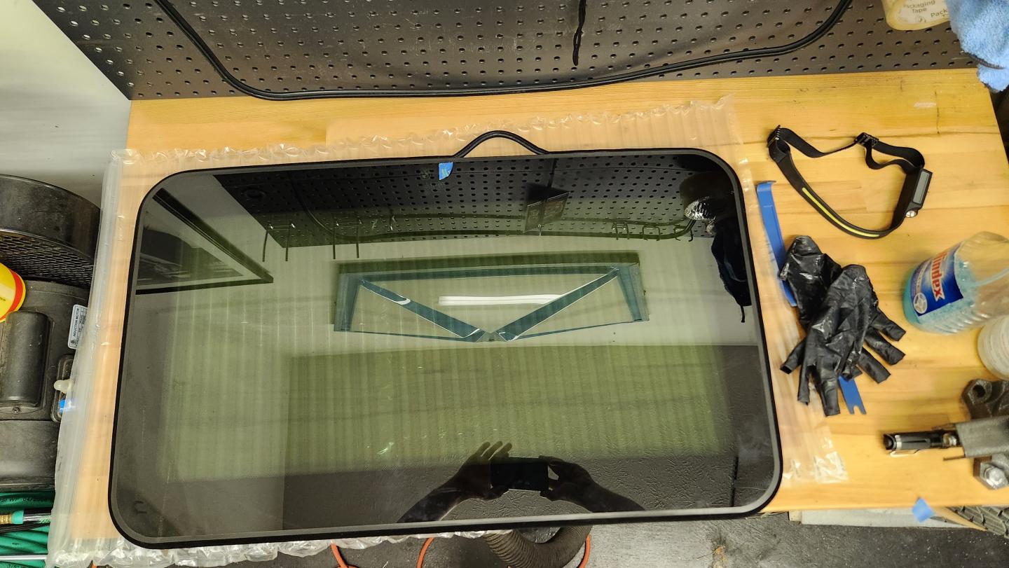

          I am on a roll today... $85 sunroof seal won't fit without cutting it, awesome!

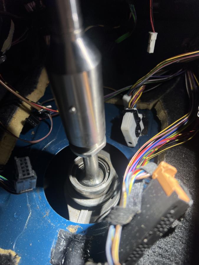

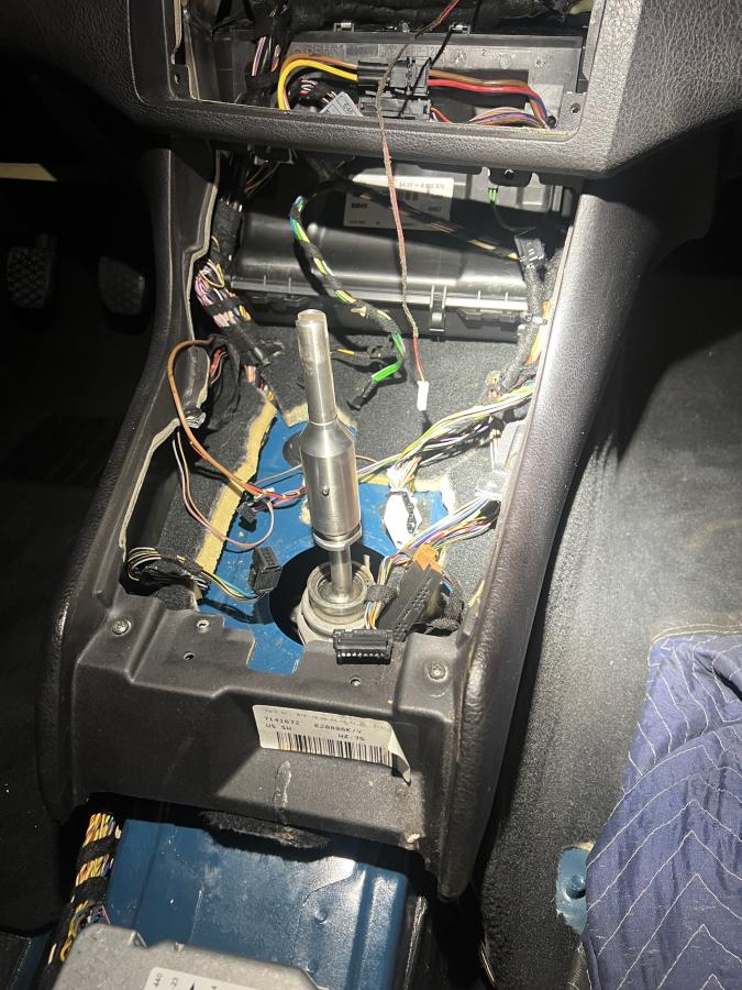

              in the middle of an interior swap, thinking through what solution to get for the shifter as it's notchy as hell.
              Anyone seen this shifter and boot before? PO changed from stock to a "short shifter" but couldn't recall the type, brand.
                Appears to be an Autosolutions SSK.
                      Wow i’m surprised given all the great reviews. This must be one of the greater reduction units but still, not the most buttery smooth shifting. Perhaps i need to try different trans fluid. Also have a new weighted oe knob ready to go in.
                      Edit. Took the boot off, pretty sure it(the boot) was just installed wacky.
                      No branding on the shift lever that I can see. I also inspected the stock parts that were removed, which only included the lever and selector rod. So that leads me to believe this is just a ssk lever and selector rod replacement, which would explain the notchy crappy shifting.
                        On closer inspection in that picture, it looks to be UUC and not Autosolutions. I had to see the shift arm which didn't show up in the earlier pictures.
                          https://www.ecstuning.com/b-scratch-...SABEgLHqvD_BwE
                          I dont see the set screws on the shift carrier.
                            If it sucks it must be from UUC.
                              Should the sunroof glass perimeter seal be able to be installed as once piece or is it sometime required to cut it to fit?
                              My original seal came off as one piece but the new seal I had to cut, it was too large so I cut ~1/2" at the seam for it to fit. I'm sure it will seal fine but I would prefer it to be one continuous piece if possible.
                                the 3 screws are there just hard to see in the pic. i do think it's a uuc though their site offers very limited description and pictures of what their kit includes. looks like an autosolution kit is in order.
                                i didn't hate it on my e36. shifted like butter with new detents. but man this setup on the e46 is nearly undriveable.
