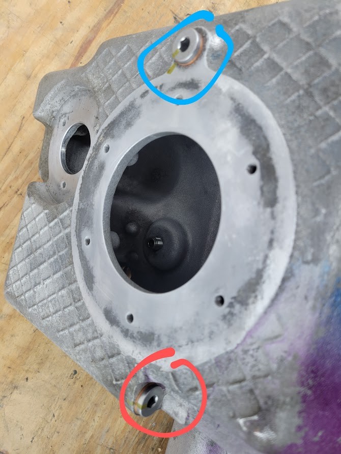

      What is the drain plug circled in red for? Click image for larger version

            There should not be a plug there. It should have a fitting that connects to a braided line and that hard line connects to the valve cover to return oil from the oil separator mounted on the valve cover. bimmerfan08 mentions an updated fitting for the early oil pans in the rod bearing DIY.

              Thank you. This pan is going on an S50 motor so I don't need that oil return line so I plugged it off.
