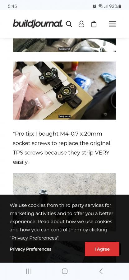

        I just did this and wish I could tell you bolt size, I went to ACE and just compared and used thier pitch finder board and easily found the right stuff.
        This is from screeshot from a DIY off buildjornal.
        Click image for larger version  Name:	Screenshot_20231022_174502_Chrome.jpg Views:	22 Size:	53.1 KB ID:	239123
        Awesome, thanks for that! I didn't know that BuildJournal DIY had the exact specs. I looked up the exact same ones from the bag in their pic and bought them on Home Depot, here is the link for anyone else interested, $2.75 for bag of 3:
        https://www.homedepot.com/p/Everbilt...3248/204281931

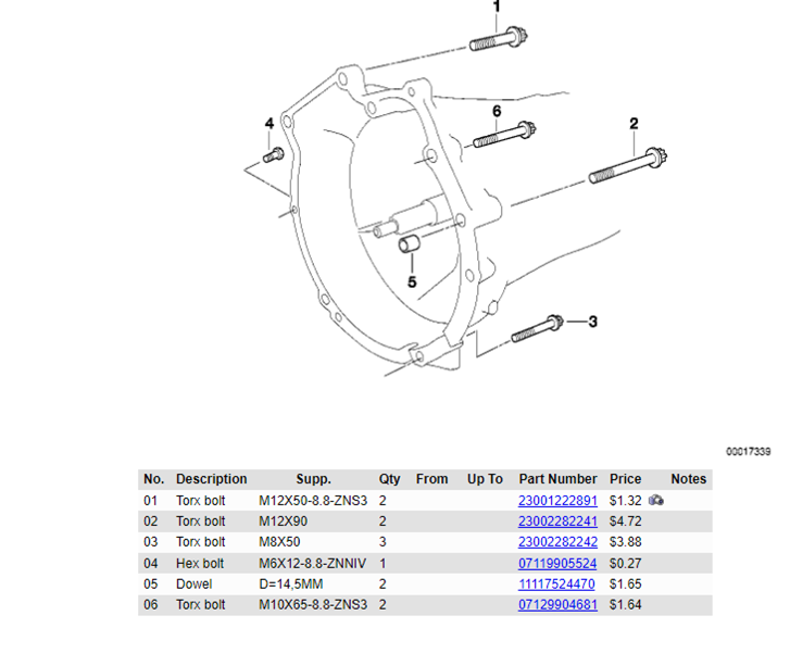

          Does anyone know what the hex bolt (M6) identified as # 4 in the bellhousing image is for? Thanks...
            Pretty sure that's to retain that sheet-metal shield or "gasket". Not sure what it is called...I'll try to find a picture or something.
            Edit: retains this https://www.ecstuning.com/b-genuine-...BoCMmoQAvD_BwE

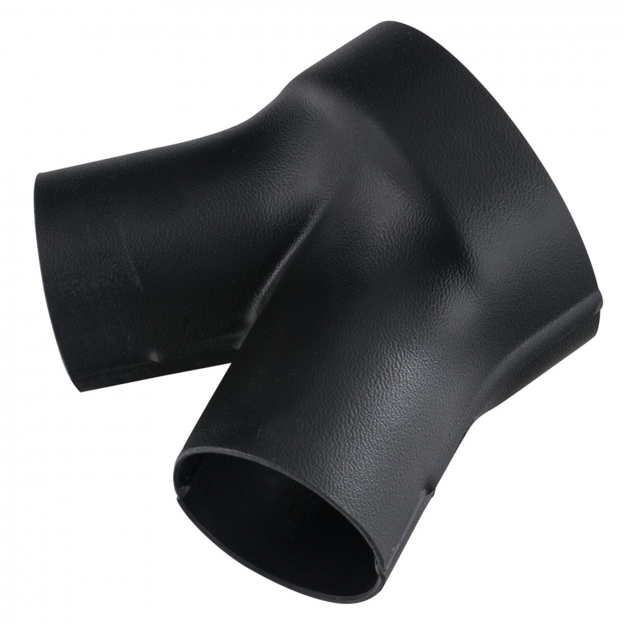

                  I would either cap it off or duct it as it will draw in hot engine bay air otherwise. However many people just leave it open and don't run the flap and don't seem to have any real problems. The eventuri scoop is a nice middle ground as far as getting in cooler air, or so it would seem.
                  Just wanted to duct as much cool air to the intake as possible as I am running the CSL intake without the intake tract/bumper it was designed to run with.
                  I haven't put any thought into this so could easily not even be possible due to spacing. Just throwing it out there before going to bed because of the beauty of this thread.

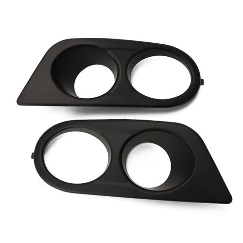

                  Considering deleting the fogs on my car so I had the thought of a setup using something like one of those dual hole cover plates running flex pipe from the 2 holes to the snorkel, secondary hole and then brake cooling duct using a Y splitter somewhere. Gut instinct is that it's not possible to fit / it's not worth the effort but that's why we all love the E46 anyway. Any chance there's something there worth looking into?

                    That may just work but if you do a small amount of cutting on the factory ducting you can have some air going to the airbox and some going to the brakes as well still.
