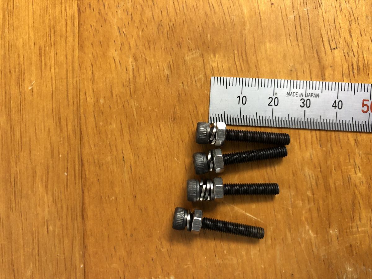

                          Looking to preemptively replace my TPS, and I see alot of folks mention replacing the OE screws that strip easily (pn 13541726918) with allen/hex or torx head screws; what thread pitch and length should I be looking for the replacements?
                            You know RealOEM lists this (for any part numbers)?
                              I just did this and wish I could tell you bolt size, I went to ACE and just compared and used thier pitch finder board and easily found the right stuff.
                                According to Real OEM, the Pozi screw is M4x25mm. I dug around in the fastener bin at work and decided on some M4 socket cap screws (3mm hex drive) in 25mm length with a lock washer. I've not yet done this myself, but I plan to, and these are the screws I'll attempt to replace the Pozis with.
