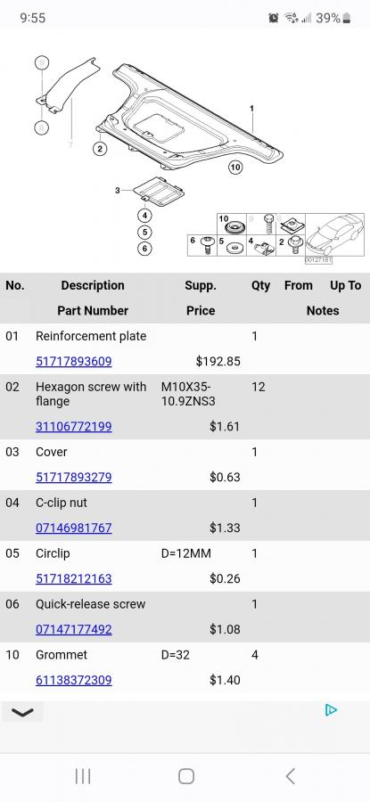

      There are two different sets of c-clip/body nuts on the front support plate (3 each), that connect the under carriage diaper and other trim. One set is for short 10mm head screws and their other for 8mm screws. Anybody have the part numbers for each of these nuts? Mines are all stripped out and I can't find the PN. The initial parts I bought from FCP are incorrect. TIA!
      It's not the -767 part no. 4 all around?

        Unfortunately not. That was one of the part numbers I ordered from referencing the same diagram and it wasn't correct.
          I'm looking for those c-clip nuts as well but I dont think they have their own part number. I'm probably just going to replace them with a generic version from the autoparts store.
            I'm open to that solution as well. Be sure to report back if you find some that are compatible!

                      I don't know what the ones on your car look like, but based on the diagram, this may be it? Don't quote me on it. BMW seem to use this part on a ton of different models.
                      https://www.ecstuning.com/b-genuine-...h/07129904150/ (this one says its for 8mm and 9mm, Body nut used to attach underbody shields to the car.)
                      https://www.ecstuning.com/b-genuine-...t/07129904220/
                      If you search "BMW body nut" on Turner there are a ton of different options. Maybe pull the one from your car and visually compare what you see on screen?
