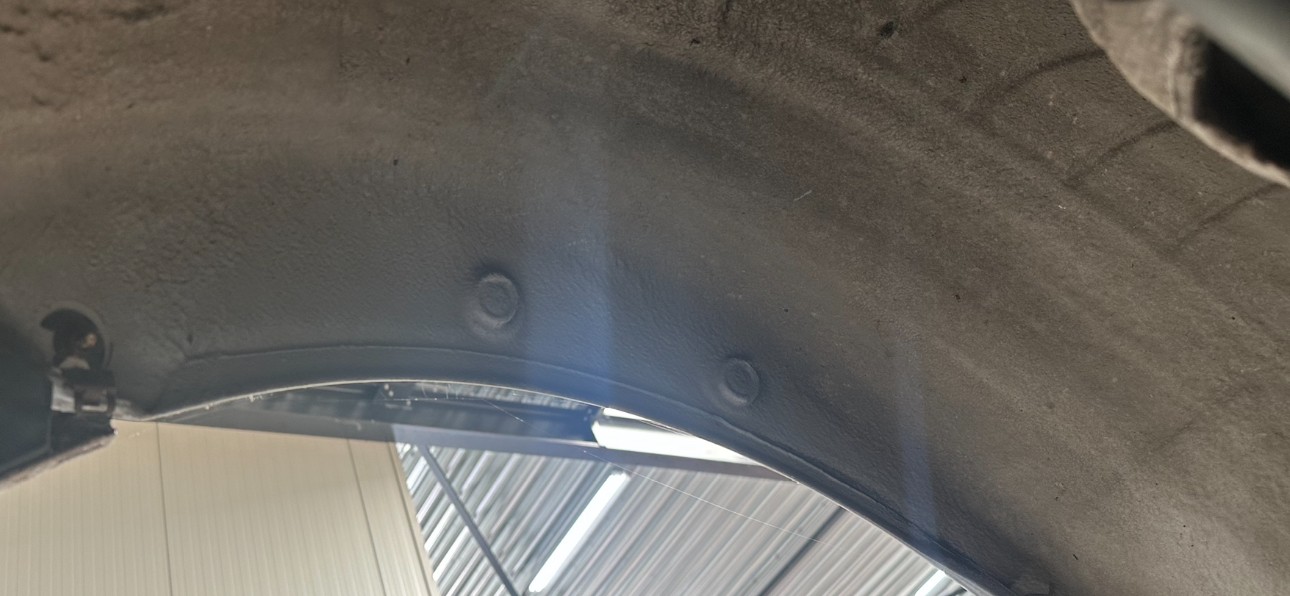

        Ah interesting, I was wondering why even with the fender pull the lip wasnt flat and still so thick. Thanks, yeah that sounds like a better solution, ill try that instead of cutting, less chance of accidentally cutting a spot weld too lol.
        EDIT- following up, after taking another look at the inner lip, the shop that pulled the fenders pinched the top of the lip ‘channel’ closed, so wont be able to get a wire wheel in there to clear out the rubber :/
        The inner and outer arch meet there as kind of an U shape which not your typical L shape that you can easily roll, the U shape is very strong.
        There are spot welds are on the inboard side of the U shape, if you cut off the entire channel, your inner and outer arch will no longer be connected to eachother, you can solve that by welding the entire perimeter, which is what I have on my personal car, but obviously it will need painting on the outer arches at that point, you also need to be careful of heat control and warpage.
        Another approach without welding is to first cut the U shape into the L shape, by removing the inner edge with the spot welds, and then carefully only cut out the inner arch part of the L shape, not the outer arch part, then apply panel bond adhesive and fold the outer arch over the now cut inner arch, and seam seal it afterwards, that is how a CSL is from factory.

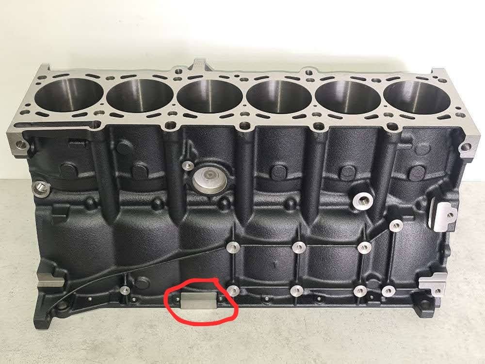

                I'd like to know how to check if the original engine is still present in the car. Buddy of mine is selling a car with a swapped motor and I'd like to help him disclose that. Is there an engine serial number plate with part of the chassis VIN in it, or is this confirmed another way?
                  yes you can check the number on the block. it's engraved and you can see on the picture where. just turn in the right front wheel, don't need to jack up the car. with the number and the vin you can at least check if it's the original block. you can go to BMW or you can try to ask free car dealers with access to a car data base.
