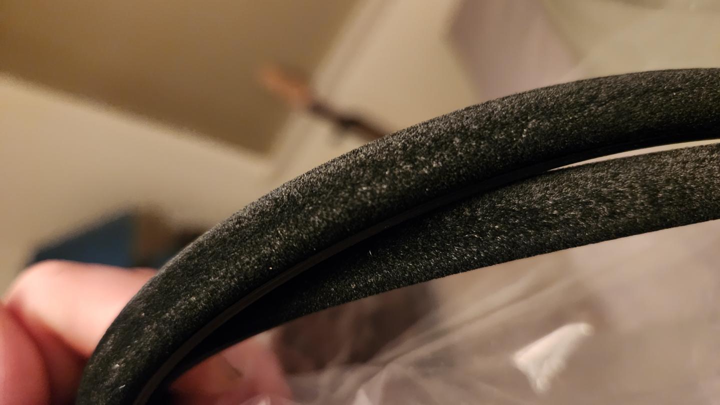

        I bought a new sunroof seal (54138218001) for aesthetic reasons and noticed it has a felt like look/feel to the outside of it, something I don't notice on the original seal on my car.
        Is this normal for the sunroof seal to have this almost fabric feel and texture when new?
        Also the sunroof seal came with 6 small torx screws yet I see no holes in the new seal, what are those guys for?
          I believe the fuzziness is normal. My car has some fuzzy remaining, it appears to degrade/wear off over time. Glad to know this is a part that can be purchased.
          Oh the torx screws are likely to secure the glass to the mechanism--you'll have to pull the glass to replace that seal. I've pulled the glass 2 or three times--the hard part is getting it level in my experience. If you determine a straightforward method please share.

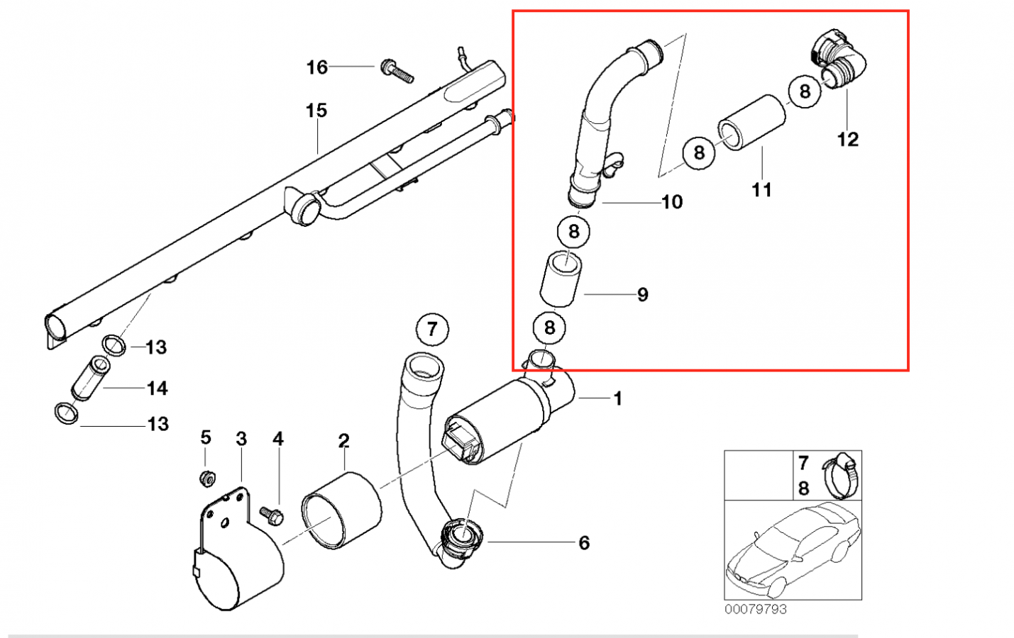

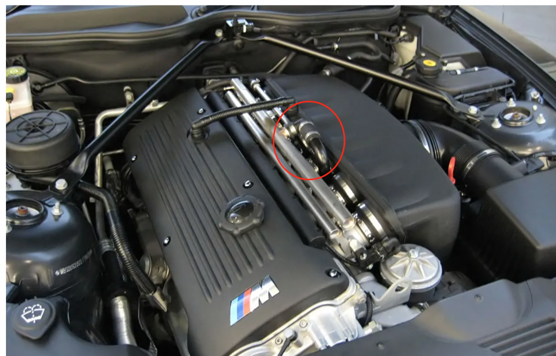

              Anyone know the part number for this hose? Having a hard time finding it in RealOEM
              Click image for larger version  Name:	Screen Shot 2023-07-31 at 4.03.39 PM.png Views:	0 Size:	1.03 MB ID:	227371
              Edit: I think I found it. It's an assembly. I needed the quick disconnect. My Rogue Engineering strut tower brace is hitting up against this after installing new engine mounts last Fall. The engine is sitting up as high as it ever will...need to replace this quick disconnect.
              Parts Diagram Link:

                it's under "fuel"

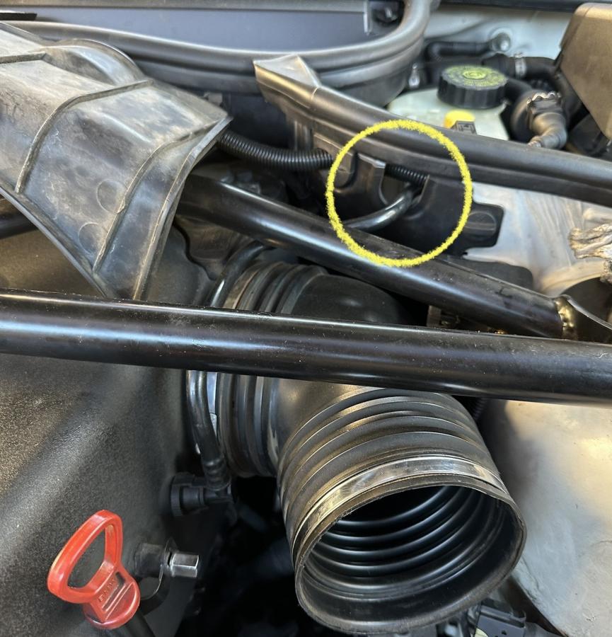

                  Got another parts inquiry question. What is the part number for the rubber grommet that goes in this opening?
                      Believe that is 11611435984
                        Thank you, sir! That's the one
