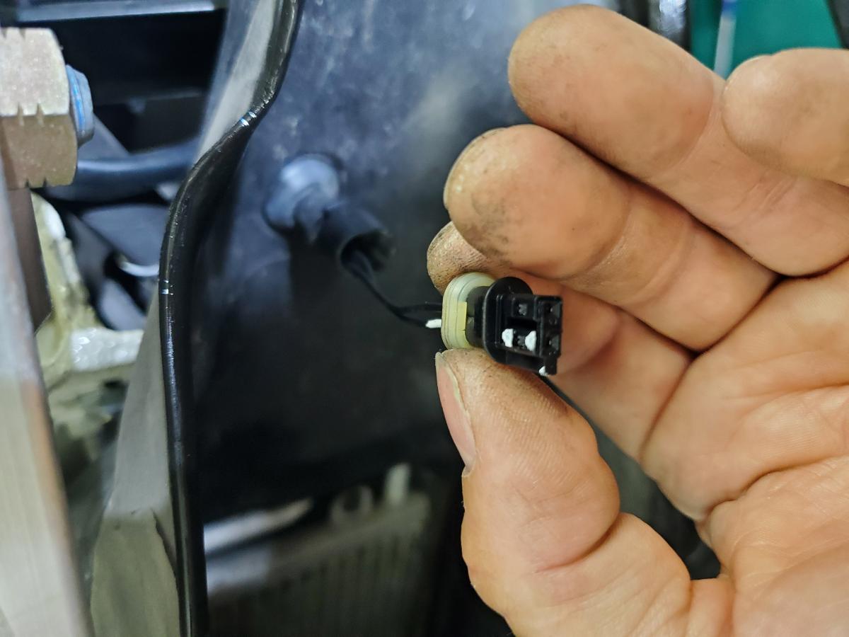

    You will need to de-pin it, look at the front of the connector, I *think* it has a small white plastic piece that you can remove and have access to de-pin.
    I might be thinking of an ambient air temp sensor though.But take a look at it, it should be relatively easy to de-pin.
    It does, so after removing the white portion, is de-pinning a matter of just pulling the terminals out? I have a terminal tool, but, I never like doing this kind of thing. Ordered the rubber boot anyhow, b/c now this is bothering my; why no boot on this connector ??!!
      So with the white portion out of the way you should be able to depress the little tabs that hold the pins in place. A 45° pick should work well.
      Here is a connector from a different car but might be similar, your looking to depress these tabs and then simply pull the wire/Pin out from the back of the connector itself.

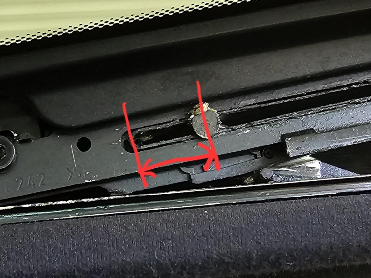

        Tilting up is a feature when you push the sunroof button forward when it's already closed. Click backwards once to return and again to open normally.
        sorry, I should have made my question a little more clear as I am aware of the tilt function.
        I'm talking about this:

          Tilt is push the button in (towards the sky) , not forward.
          Roof in question is the same as mine. Pretty sure the gap you're worried about will "close up" when you "untilt it"

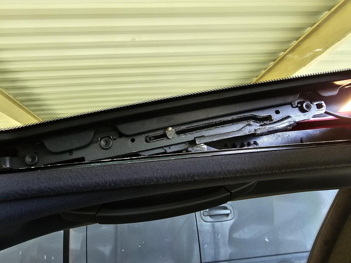

                Sunroof question: is this normal when the panel is tilted up? I noticed it could go higher but it only goes to there.

                This is what mine looks like when tilted up.
                I think it is similar to yours. Should be OK I guess.

                          Shonky HanSooloo thanks for confirming it's normal to have that space. Been wondering about that ever since I got the car over 5 years ago. I forgot about it until I opened the sunroof again the other week to enjoy the warmer weather.
