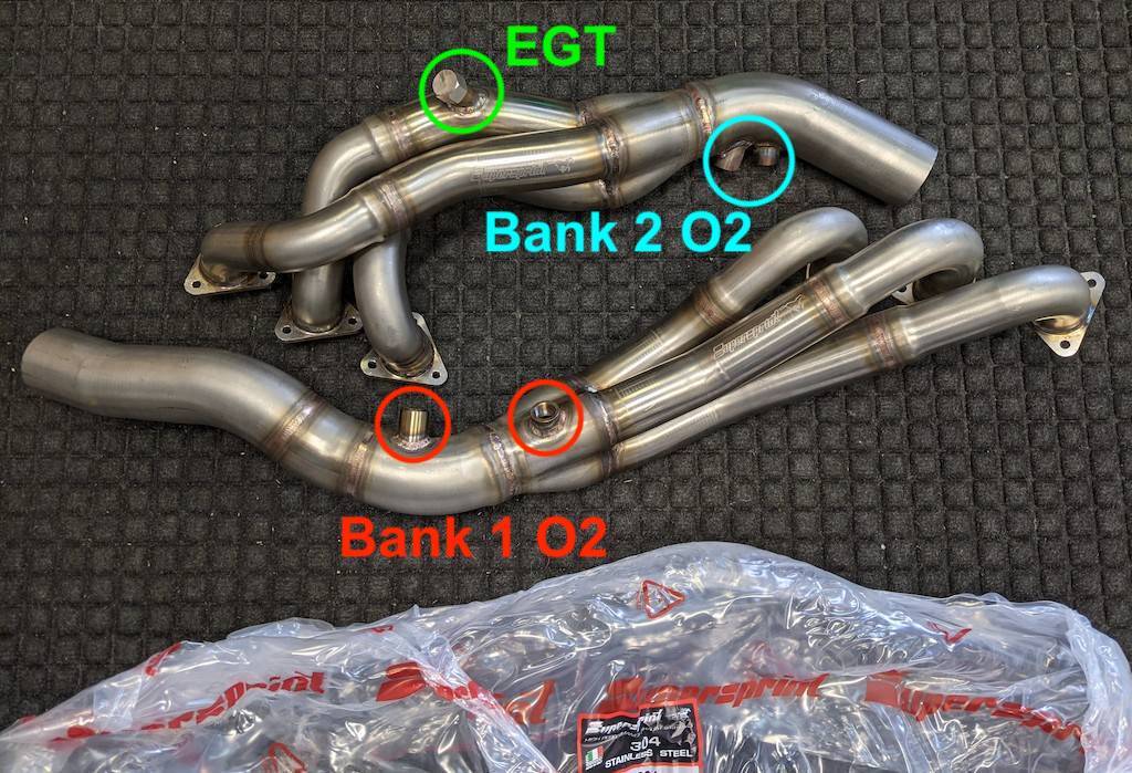

        For those of you with SSV1s, where did you place your sensors (if it even matters at all)? I see two bungs per header for O2 sensors and there's also a bung for the EGT sensor on both the headers and the catted section 1.
        As far as I understand, the EGT is only there to protect the cats, so I think it makes sense to use the bung on the section 1 for that, as it'll be closer to the cats.
        For the bank 2 header, the O2 bungs are right next to each other, so I can't imagine that matters too much. However, for the bank 1 header, there's one bung downstream of the collector and one in the middle of it. Which one should I use?
        Not my pic, but I've labeled what I'm talking about here:

          Just use the ones highest up, and cap the secondaries. I don't use EGT, but I agree that you should put it closer to the cats, so in sect 1 if your sect 1 has cats and the pipes have an egt bung ofc.
