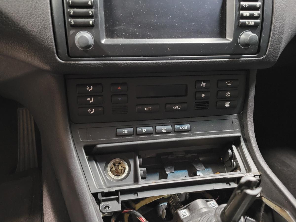

            I have the two lower screws removed - is the hvac/cig lighter just held in by upper clips or do I have to remove screws from behind the head unit to get it out? I have seen conflicting info. The hvac unit does not appear to have any hard mounting from what the part # shows.
            Click image for larger version  Name:	20260224_204906.jpg Views:	0 Size:	111.6 KB ID:	344447

              Controls just pop out. No screws. It is easier push from behind when the Nav unit is out -

                Thanks! Got it out today, was just getting nervous with cold, old plastic. My error was trying to pop the whole piece out as one. HVAC unit pops out from within the bezel, then the bezel has two more upper screws that need to be removed. Those are only accessible after the HVAC is popped out. Managed that without any broken plastic or bloody fingers so I'm counting today as a win. Better stop now.
