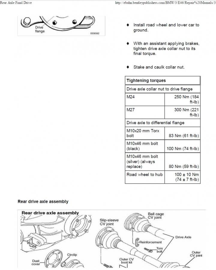

    How many times have you guys re-used your driveshaft>diff. / axle>diff. bolts?
    As we know the HW is extremely expensive, the axle bolts are $16 a piece ×12.
    These are not torque to yield are they?
    I plan on re-using mine for a 3rd time (under my ownership) and just using some blue loctite.
    There are silver ones (33217571990) and black ones (33211227664). Both are M10X46. The silver ones hold the DS to the input flange on the diff. The black ones hold the axle to the diff output flanges (L/R).
    I have heard and according to Bentley: The black ones do not need to be replaced every time. The silver ones are TTY and do.

    According to TIS when removing the rear axle from the diff you need to replace the 6 E-12 bolts. These bolts are like $16 each. Clearly these are a critical bolt, however do people really replace them each time they remove the axle from the diff?
    I replaced mine (black ones / 33211227664) the last time I touched the rear axle, but have run them more than once previously.

        I know, that will be where I buy when I buy of course, but really wondering how necessary it is to replace these every single time per TIS.
        As another data point I’ve reused my black driveshaft and axle bolts easily 4 or 5 times and had no issues. Might not be best practice but I never had a problem.
        On the other side of the driveshaft you need to replace the nuts for all bolts attaching to the guibo every time.
          TIS states that those black torx bolts for the axles are 10.9 grade. My guess is BMW recommend replacing due to the high torque value on those bolts and it being an important fastener (loss of drive to one axle can be a safety issue). That being said, I asked a BMW independent shop and they reuse them.
