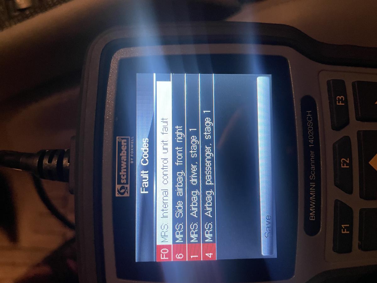

                  Intermittent crank. Airbag light on. Windows aren't fully closing when door closes. White noise from speakers with power on engine off.
                  Battery died and airbag light appeared around the same time, replaced battery. Car was fine this morning. Went back out and wouldn’t turn over.
                  There was an ews immobilizer fault, but it cleared.
                  Help would be much appreciated. Definitely seems electrical in nature.

                    Also DME 50 switch chain frictional connection
                        Yes, so that might always be there? I do have a good brown clutch switch off my race car in it.
                        I'm able to fire it up now when stomping on the clutch pedal and hitting the clutch stop. I pulled the stop and slowly went past where the stop would have been and it fired up. I'm thinking it was just barely seeing it and maybe the heat exacerbated it.
                        Still trying to figure out the airbag light and codes.
                          Yeah, I think the DME 50 switch chain frictional connection is smg-to-6spd based possibly...
                          The airbag codes, I believe it may be a bad srs module. Not sure if these fail NC which may be causing a draw while the car is off? Totally a guess here.
