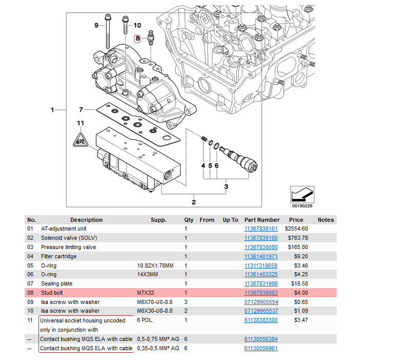

                Hi guys.
                Went to do my Beisan-vanos overhaul and the stud came out while removing the valve cover. What also came out was the threads. :/. I'm looking for advice for repair. I'm at work and forgot to bring the stud with me. I know that this is a M7x32 based on the parts diagram.
                Can anyone lead me to a direction for a recommended thread repair? Heli-coil? EZ-lok? I know this is a through hole, so that may be a factor? ** Also, the vanos is on the bench, so I will have no problems with metal shavings.
                Thanks for the help!

                    IMO the only "correct" repair here is with a TimeSert
                    I have all the sizes on hand and have never had one fail. In fact I just stuck (2) into an M62tu yesterday to repair the threads for a vanos solenoid gasket. Super easy to use especially with the part off the car.

                      I would to timesert if there is space for it.
                        Damn those things are spendy! I appreciate your feedback. I'll order one today!
                          Yes, they are expensive. but also quite effective, if anything, the repaired joint will be stronger.
