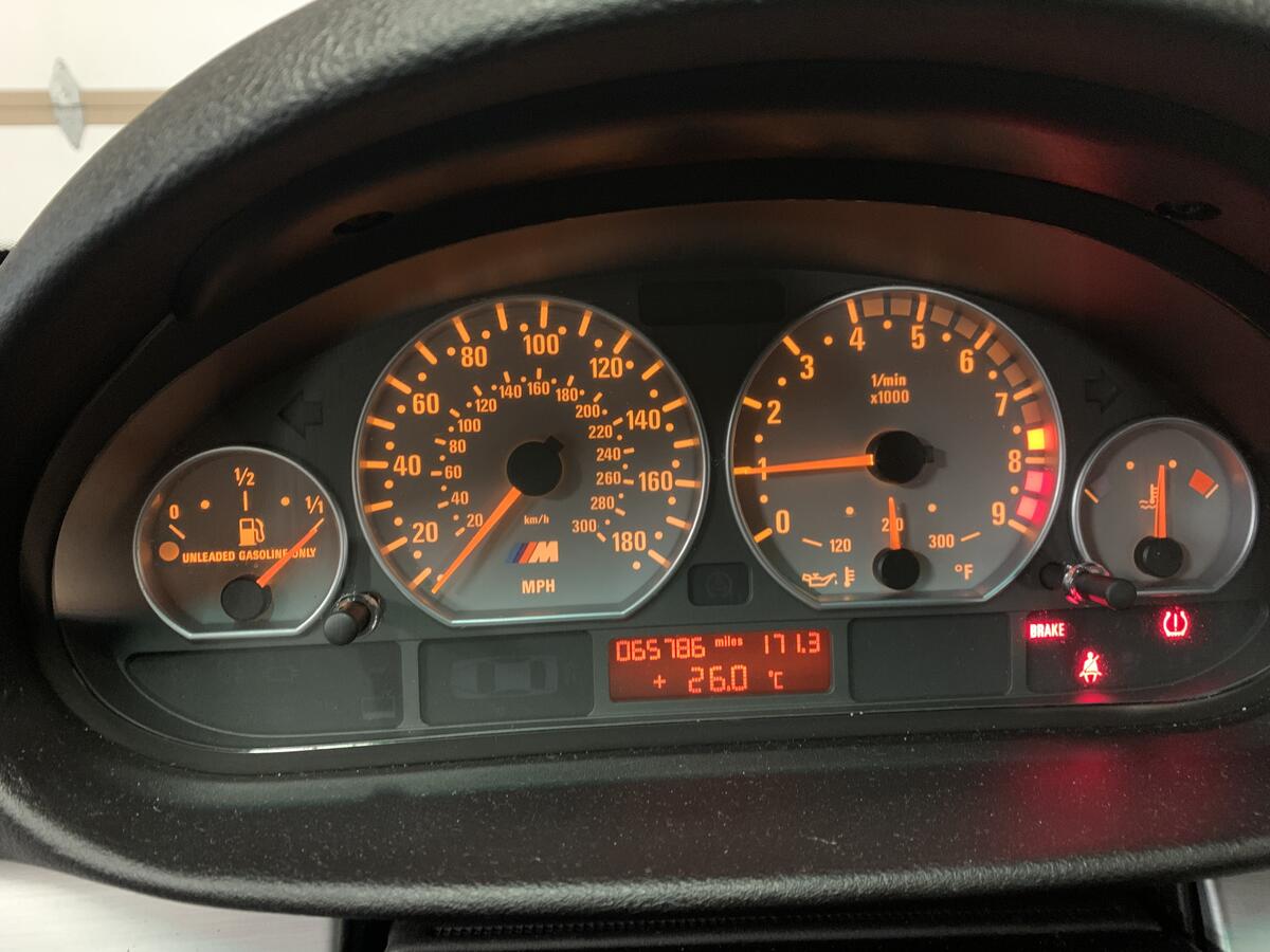

                            Tire Pressure Reset
                            I'm apparently not smart enough to get this done even after reading the manual. Tires were low, I inflated them back to 33F and 38R. Red light is on, not amber. Amber shows up when I press the reset button once. Still, I drive off and nothing changes. I hold the button again and it goes away. Eventually, as tires warm up the red light comes again.
                            please explain for dummies. Thanks
                              Originally posted by CachacoE46 View Post
                              Tire Pressure Reset
                              If I remember right, you have you have the key in position 2 (engine off) then hold the tps until light goes off. Press and hold again until amber light comes on then turn on the car and slowly drive and the light goes away
                                Thanks, will try again
