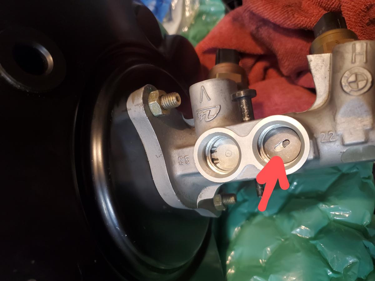

    What's this washer thing in the brake master cylinder (MK60)? A kind of one way valve?
    Refreshing the seals and cleaning everything out before installing this (and other MK60 bits) in the car and it caught my eye.

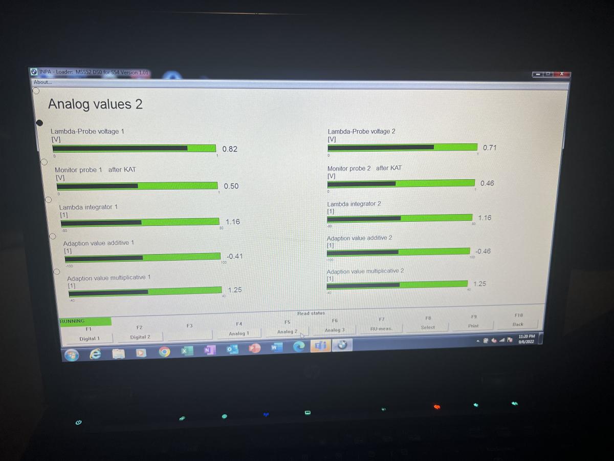

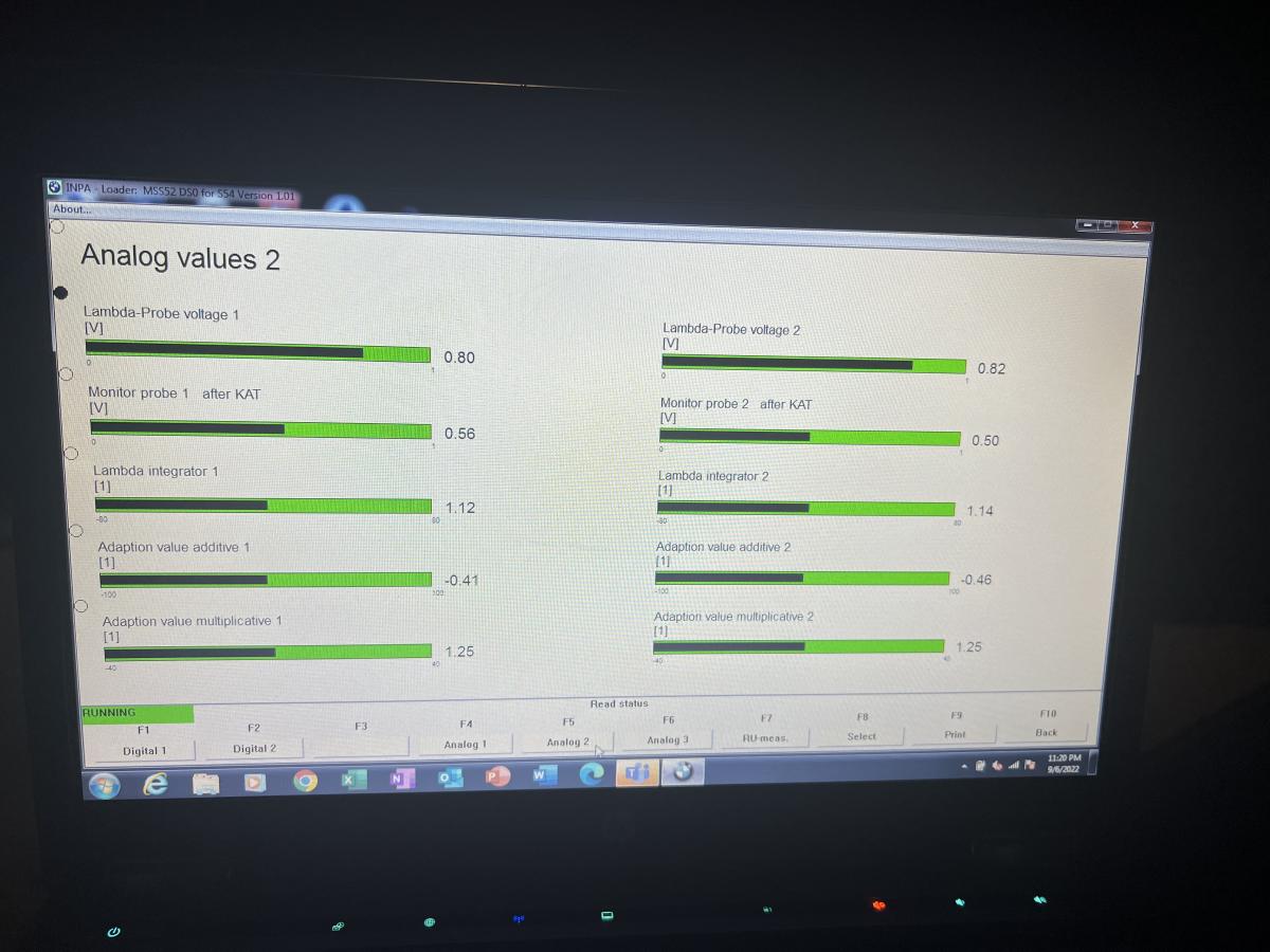

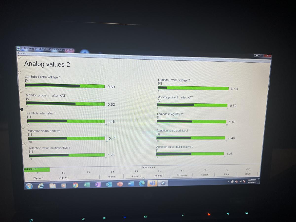

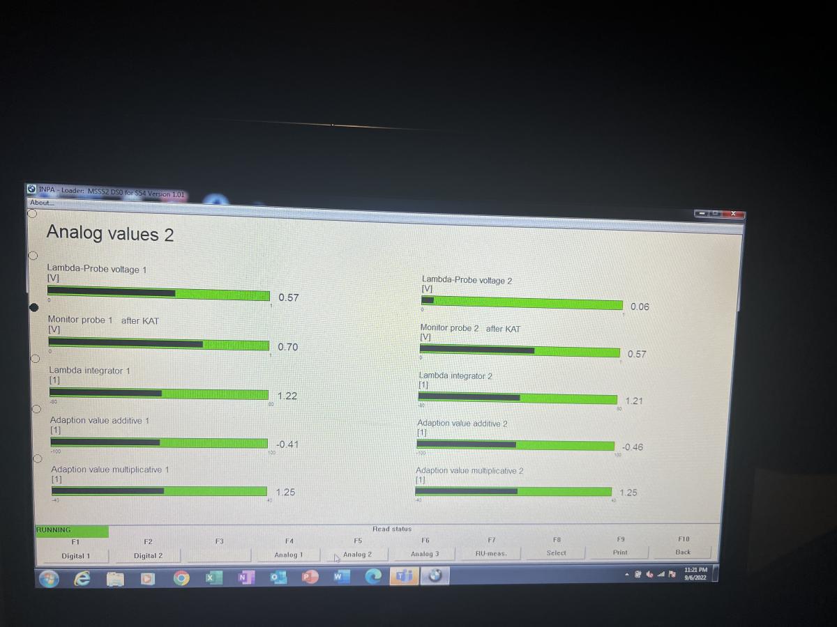

        I’m heaving a rich running condition with my car. The codes that show up at every a few drive cycles are fuel diagnosis cylinders 1-3 and 4-6. What could cause this? I have a new fuel pump, recently changed fuel injectors, fuel filter and fuel pressure regulator. I also installed new O2 sensors during the SS v1 headers (catless) install. Car has the Turner box with the MAP sensor. Rear O2s and the secondary air pump are deleted.
          Specific codes? What are you fuel trim numbers?
            Fuel system diagnosis cylinders 1-3
            Fuel system diagnosis cylinders 4-6
            These are the only two error codes that I constantly get at every 3-4 drive cycle.
              Weird, never heard of those. Do you have the ECUwerx tool? "Martyn's tool"? That'll give you the fuel adjustments/adaptations.
              Do you have the specific code #s, that might help. The codes' descriptions, as you've written them, sound vague.

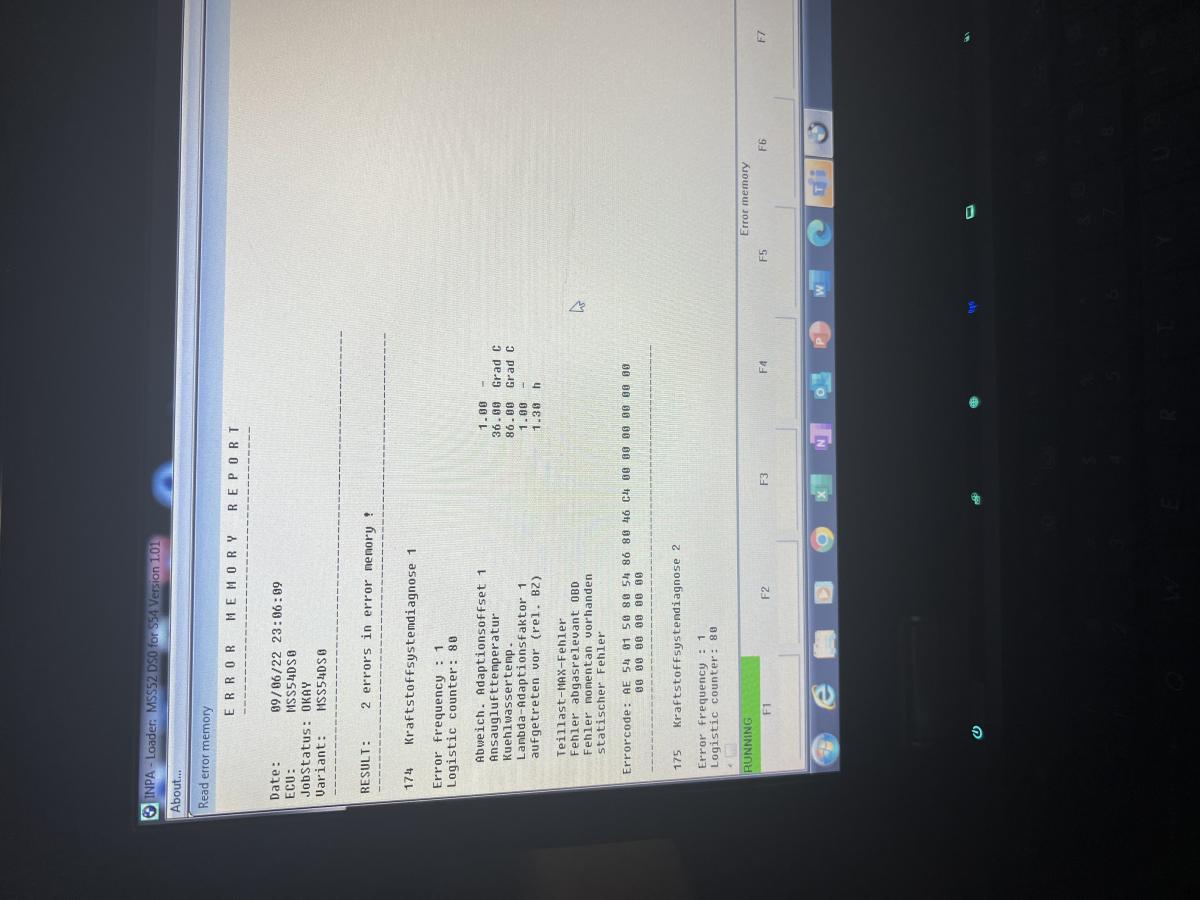

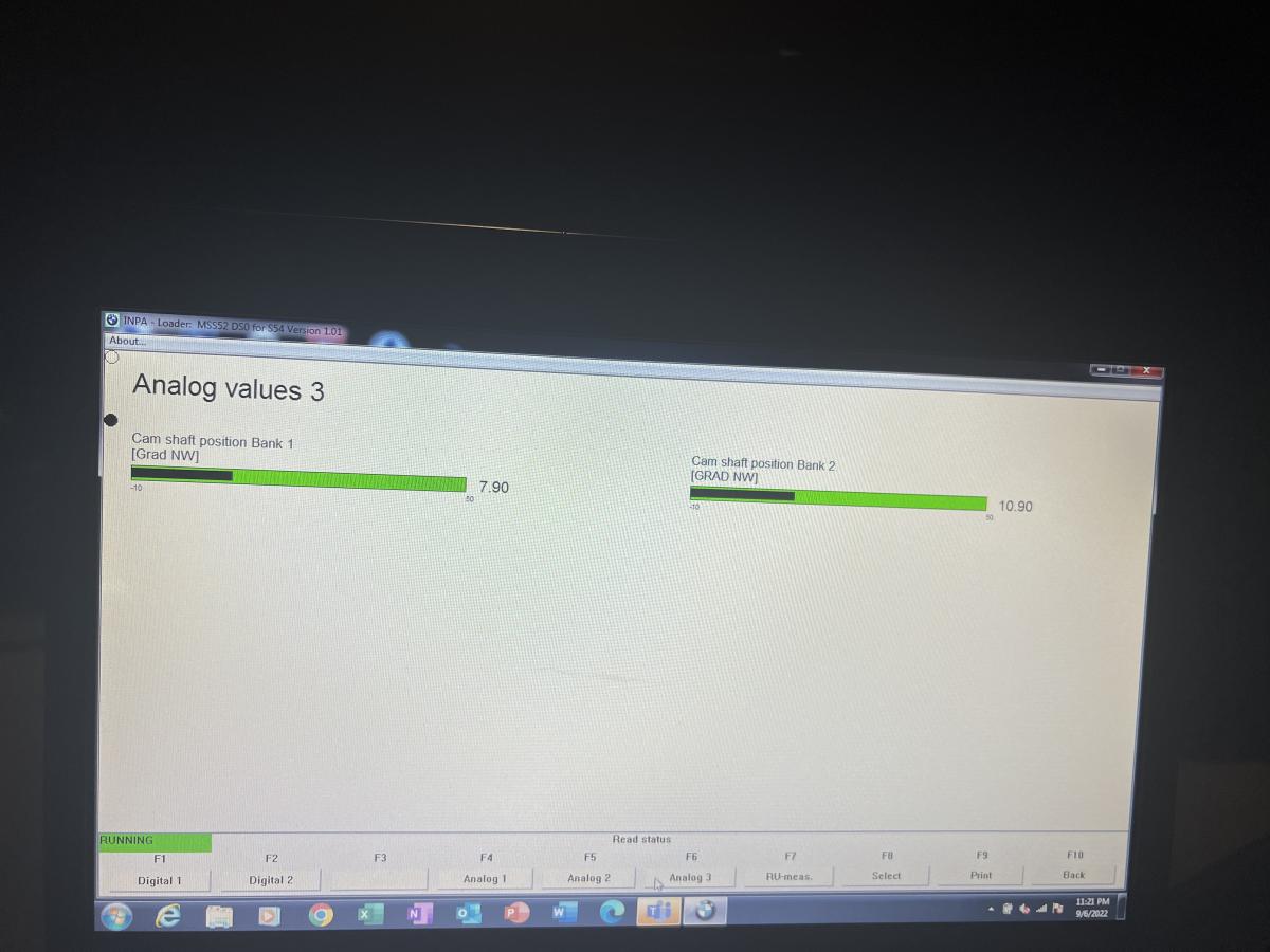

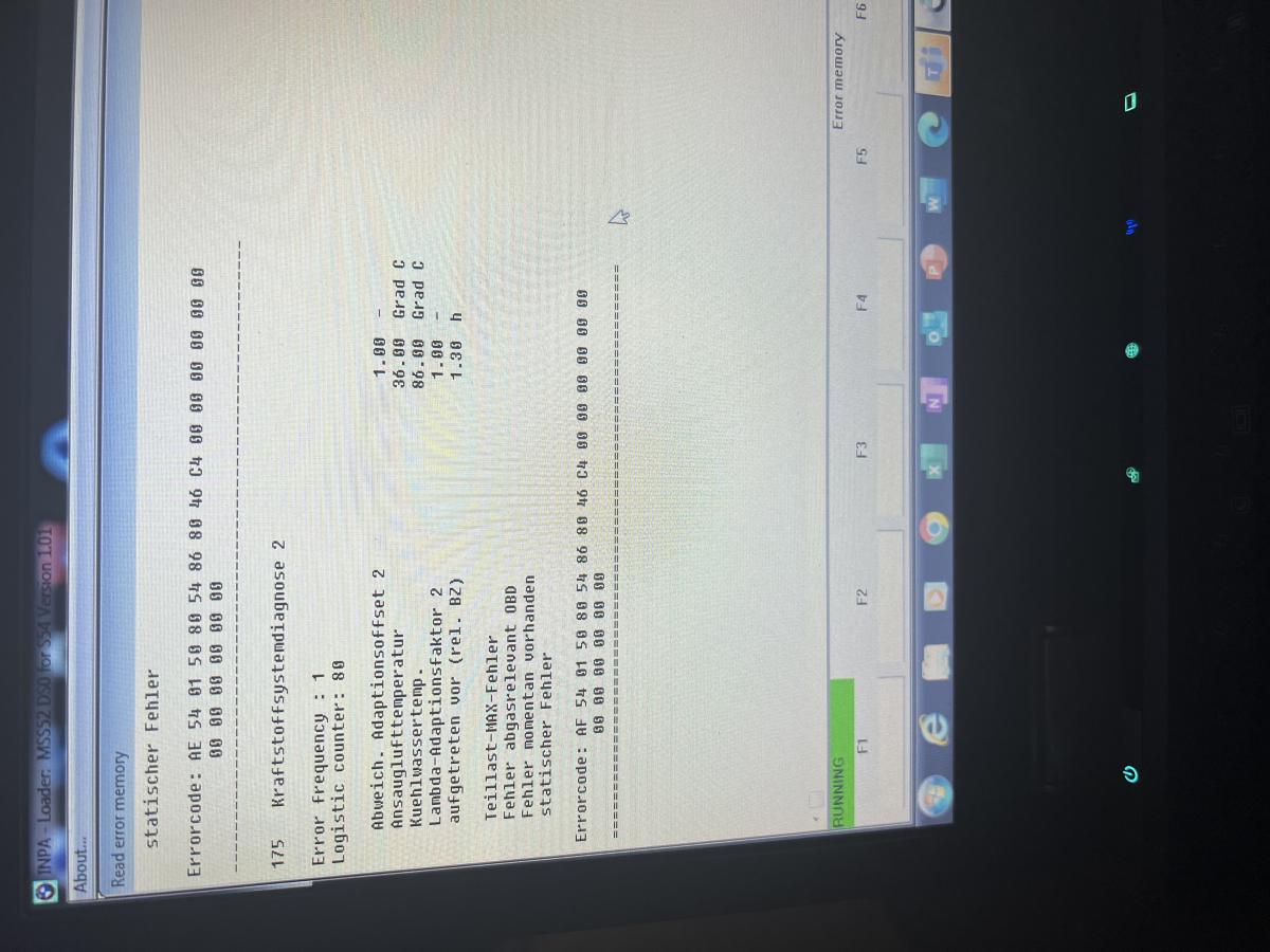

                Checked with INPA, stuff is in German. Lol
                  INPA code 174: (P0172)
                  Multiplicative mixture adaptation, cyl. 1-3 control limit reached
                  INPA Code175: (P0175)
                  Multiplicative mixture adaptation, cyl. 4-6 control limit reached

                    Intake air leak. Both banks basically needs to be something common to all cylinders. Do a smoke test.
                      I removed the Turner box twice to make sure there aren’t any damaged lines, boots etc.
