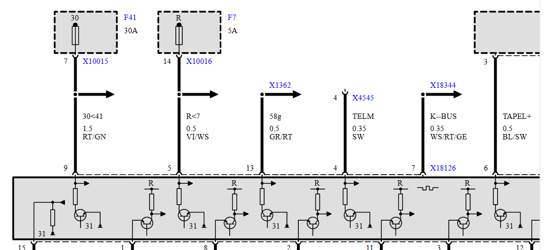

          Can somebody remind me what color wire is the 12V switched power going to the BM53 amp in the trunk? I think it's red with green stripe??
          Also, anybody what gauge wire that 12V switched line is? I'm trying ton find the right size posi-connector to tap into it.

            RT/GN (rot,gruen) is permanent 12V. Switched should be VI/WS aka violet/white.

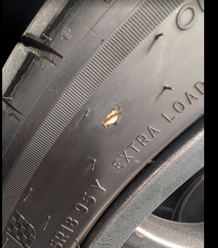

              Not sure what happened here. Been there for a while, but now it's bothering me. Should I be worried about this? Or just sharpie it and call it a day? Tires probably have like 2,000 miles on them - tops.

                to me, that just looks like a remnant of a sticker. i feel like you should be able to just pick it off.

                  Hah. Wow. I never wanted to pick at it to potentially make it worse. Picked at it, and you were right - thanks! How that never came off with all the tire cleaning and stuff I have no idea. Glad I'm in the dumb question thread. Thanks!!

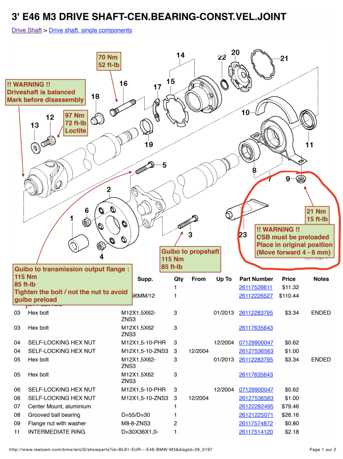

                                I'm putting my driveshaft back in and re-mounting my diff, I saw this in the torque spec PDF. Just looking to clarify what this means, and what order everything needs to be put in and torqued on the driveshaft, guibo, CSB, and all diff mounts.
