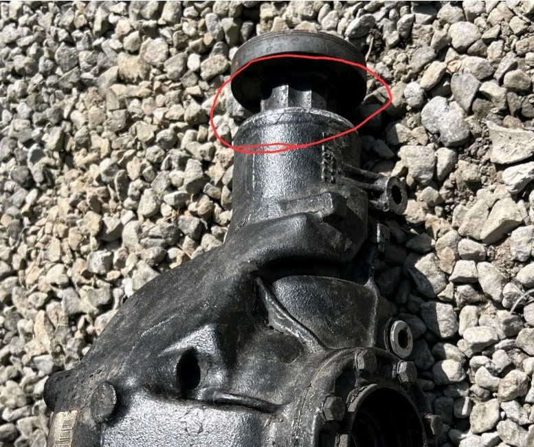

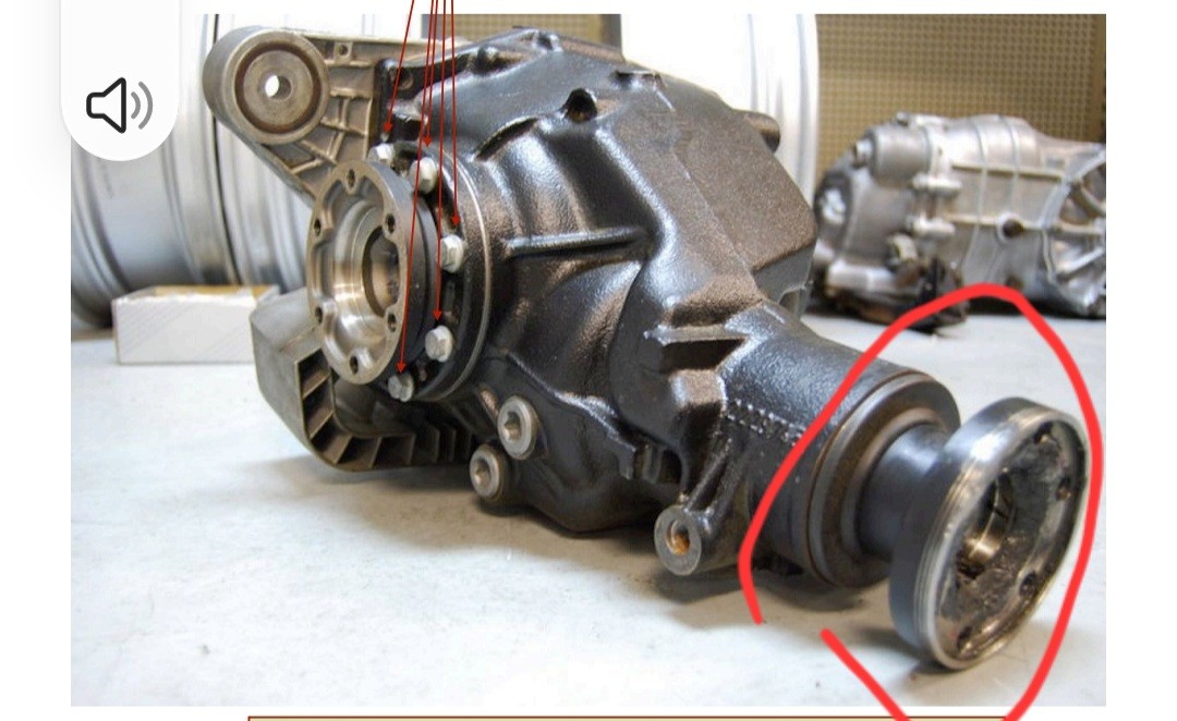

      Can a V1 vs V2 diff be differentiated by the round vs. "scalloped" input shaft? Also can V1 diffs OPF's be swapped to V2 diffs and vice-versa? From what I understand V1 diff had the short OPF on the passenger and V2 on driver's.
      I have a V1 diff (short OPF on passenger side), it also has the round input flange.
      Round:
      Click image for larger version  Name:	20220926_093751.jpg Views:	0 Size:	143.6 KB ID:	186019
      "Scalloped"
      Click image for larger version  Name:	Screenshot_20220926_093437.jpg Views:	0 Size:	223.0 KB ID:	186020

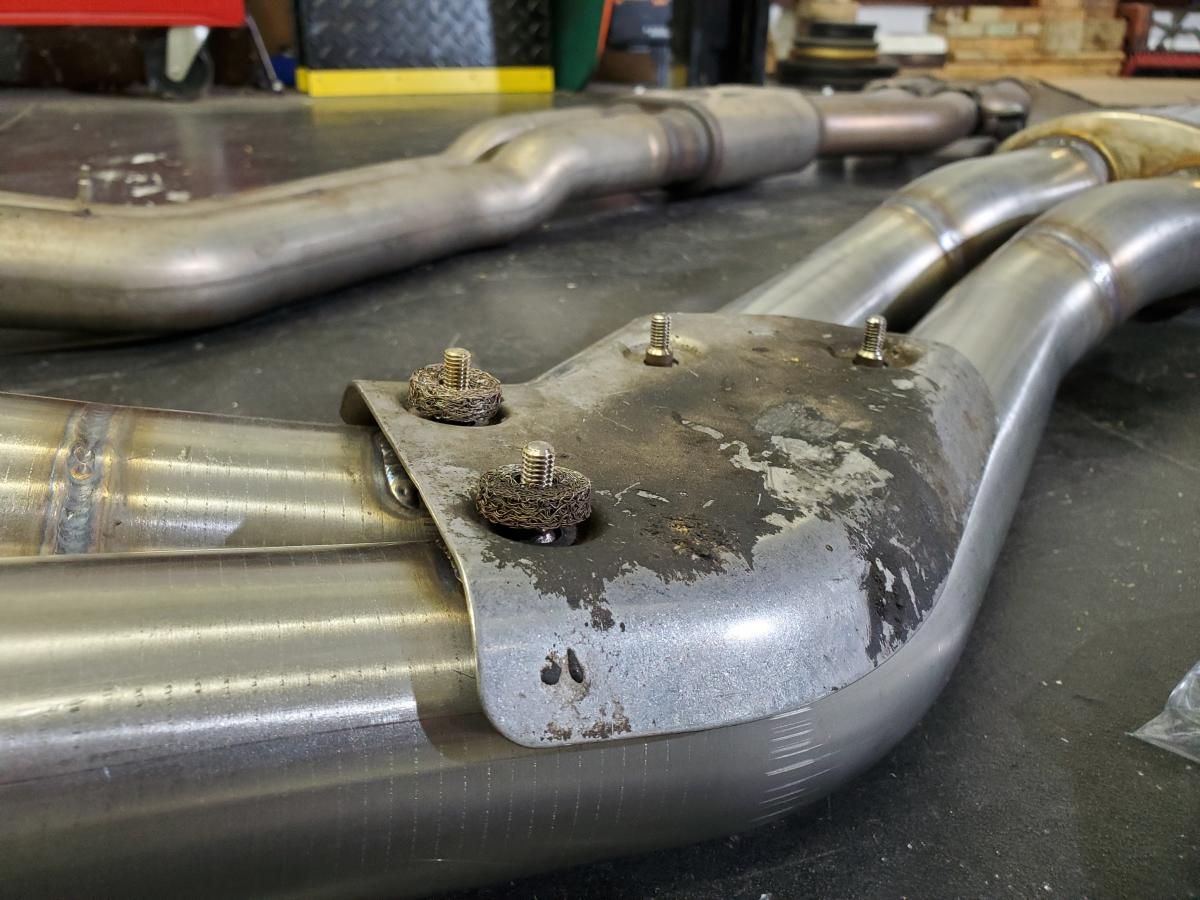

                    How does the heat sheild on top of Sec. 2 go on?
                    When I took my stock Sec. 2 off 3 of the 4 studs that hold the heatsheild were broken and I was left with 5 of these little "steelwool washers", one nut and what appears to be a non-OEM washer.
                    My question is how is the heatsheild placed on Sec. 2? Do the steelwool washers go only on top of the shield, only on bottom or do I need 8 steelwool washers for top and bottom?
                    I likely won't be able to fit the shield regardless as my aftermarket muffler raises Sec. 2 too high so even with the OEM pipe it won't fit, now with a larger (SS) Sec. 2 the gap may be even smaller.
                    Hopefully if it doesn’t fit I can continue to run without it without too much consequence but if it does fit I'd like to know how to mount it.

                        Anyone happen to know where one might source something close to these washers for Sec. 2 heatshield?
                          I think Rob found a good substitute. IIRC, it was Rob, in his street build thread if you go to the part where he's fitting the oversized SS sect 2.
                          In my experience, the aftermarket, larger pipe sits too close to the driver propshaft flange on the diff, and if you install the stock heatshield with washers underneath, the heat shield will kiss the diff flange. It probably is dependent on other factors like how the sect 2 meets the sect 3, and how you space out the crossmember braces on which the sect 2's rubber hangers sit.
                          I installed the heat shield with only 4 wire washers on top, to give myself about 1/4" clearance.
