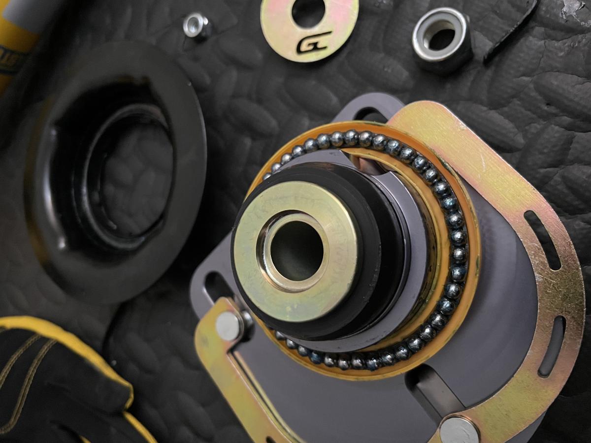

                            Hello,
                            I received camber plates like this from GC. That doesn’t seem normal. Balls were falling off when I opened the package. I am not sure how to assemble it. Anyone had the same experience ?

                              Originally posted by E46m3zcp View Post
                              Hello,
                              It looks like that OE style strut bearing is missing the lower black cover. The OE BMW one is made by INA, but it seems you can only buy the OE one with the strut mount from FCP for $22. They used to sell it separately IIRC.
                              https://www.fcpeuro.com/products/bmw...g-31331090612a
