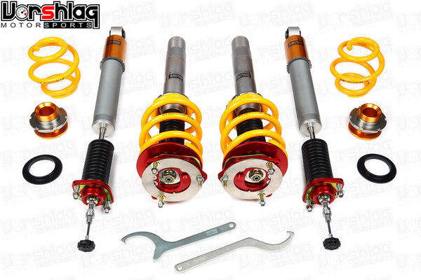

          Sorry to rag on this topic too long, but I am thinking either Ohlins or TCK's.
          Are the camber plates that come eith TCK's any good or should I be looking at other plates?
          Also I have read that that Ohlins need some type of spacer from 3DM to still have sufficient travel when lowered, just wanted to confirm.
          I am trying to make a single purchase (package deal) if possible and Vorshlag sells the Ohlins with their plates as a package but I may render the dampers useless if I go to low w/o said spacers.
          Introduction Vorshlag Motorsports is proud to offer the full line of Ohlins Road & Track Coilovers.  The Road & Track series of monotube dampers has the quality, technology, and performance we look for here at Vorshlag, we won't just sell any damper! Ohlins has been involved in racing for over 30 years and that
            Maybe create a dedicated thread? don't be shy =)
            The spacers don't increase travel they increase ride height by elevating the strut. I did not need the spacers running Z65-203-070 swift springs with Vorhslags.
                Imo, spend more for mcs/jrz or save $, and get pss10 or kwv2. Many happy people with those, they work great for what they are. Kw if you wanna go lower but billy shocks are great if you can keep it above 13.5" With gc or tms street plates and 343lb linear springs even better.
