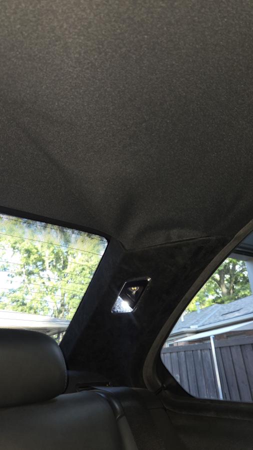

            Is there any quick and dirty way to fix a sagging headliner (other than using pins) without removing the headliner?
            Eventually I will replace the windshield and do it right.
            The area is near the driver C pillar, wondered if I could remove the pillar and use steam to maybe reactivate to glue or get some adhesive up in that area.
            Thanks for any ideas/tips.

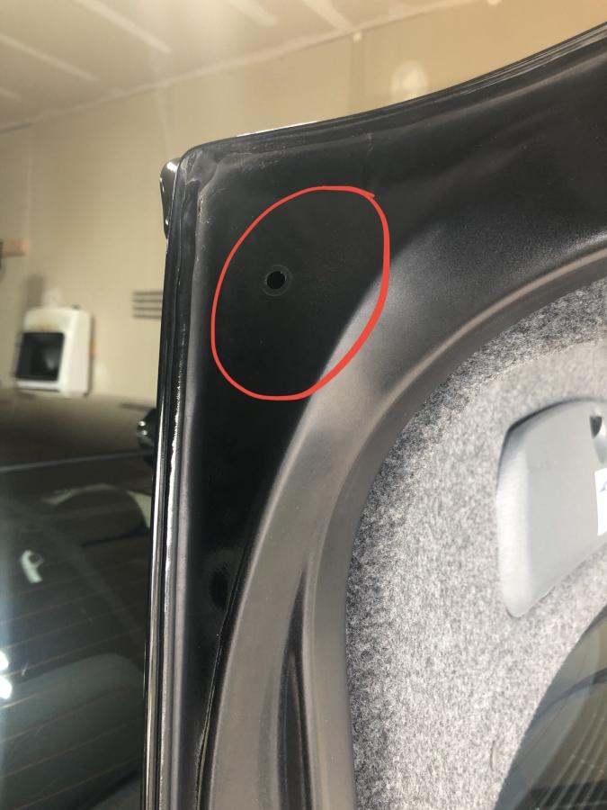

                      Struggling to find part number for the plugs that fill these holes on each side of the trunk lid…anyone have it?
