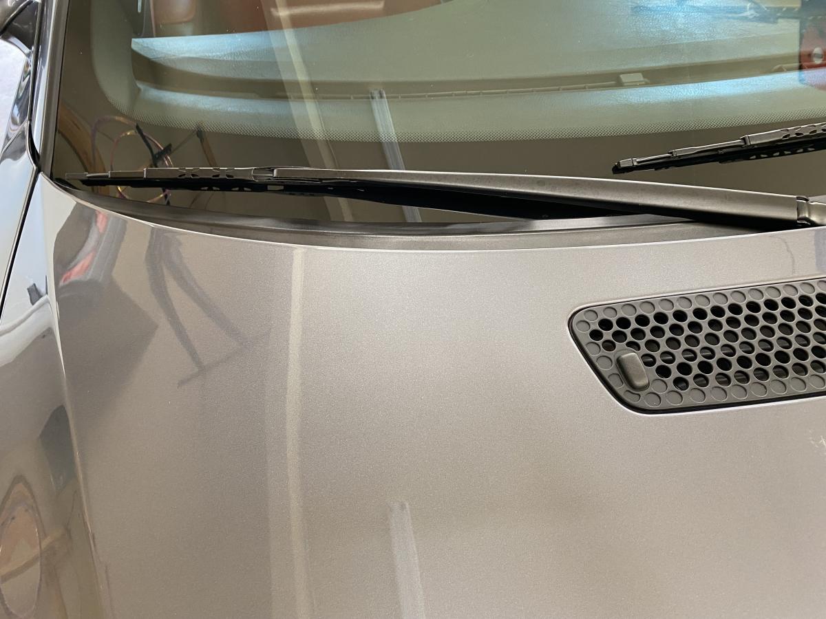

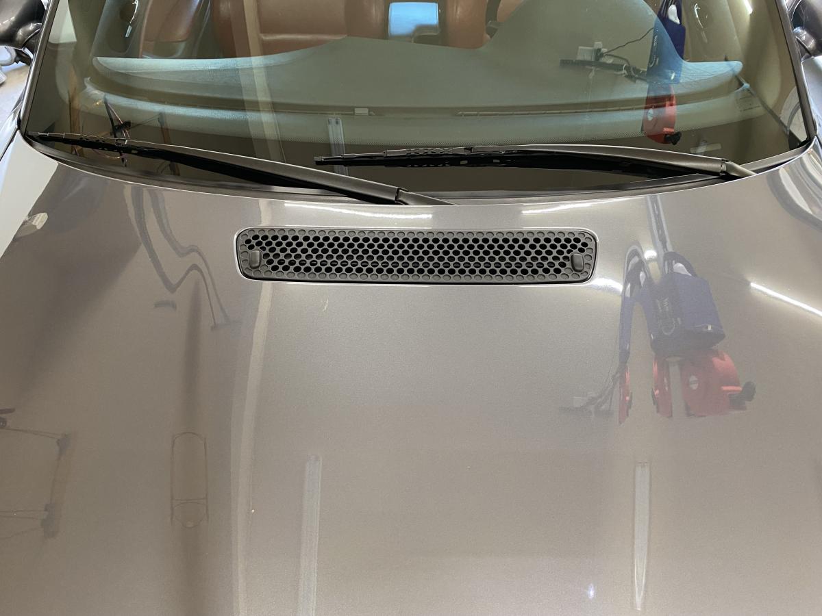

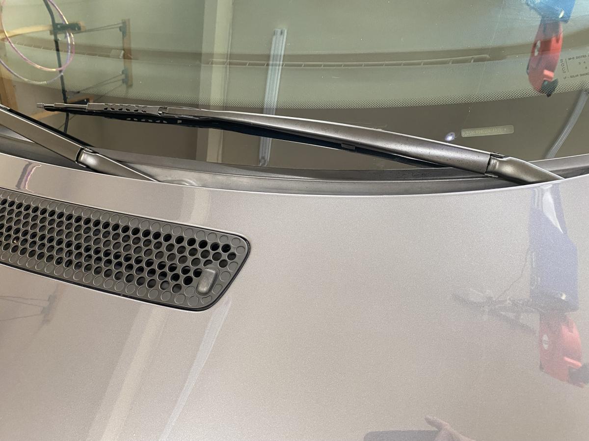

                I have a request, could someone take a quick photo of their windshield wipers/windshield, I took my wipers off and marked the metal busings, the bushings then came out of the wipers, I think I've got them close but a photo of the factory setup would be helpful.
                  I had the same problem with my wipers when I removed them so this may not be in line with the factory setup, but I hope it helps you.
                    Crap, the others didn’t load so here you go.

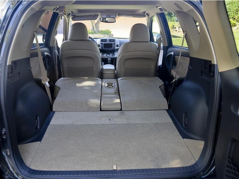

                      I have an 09 Rav4 and may have a deal for a full interior in mint condition. Will a full interior fit in the back of this Rav4?
