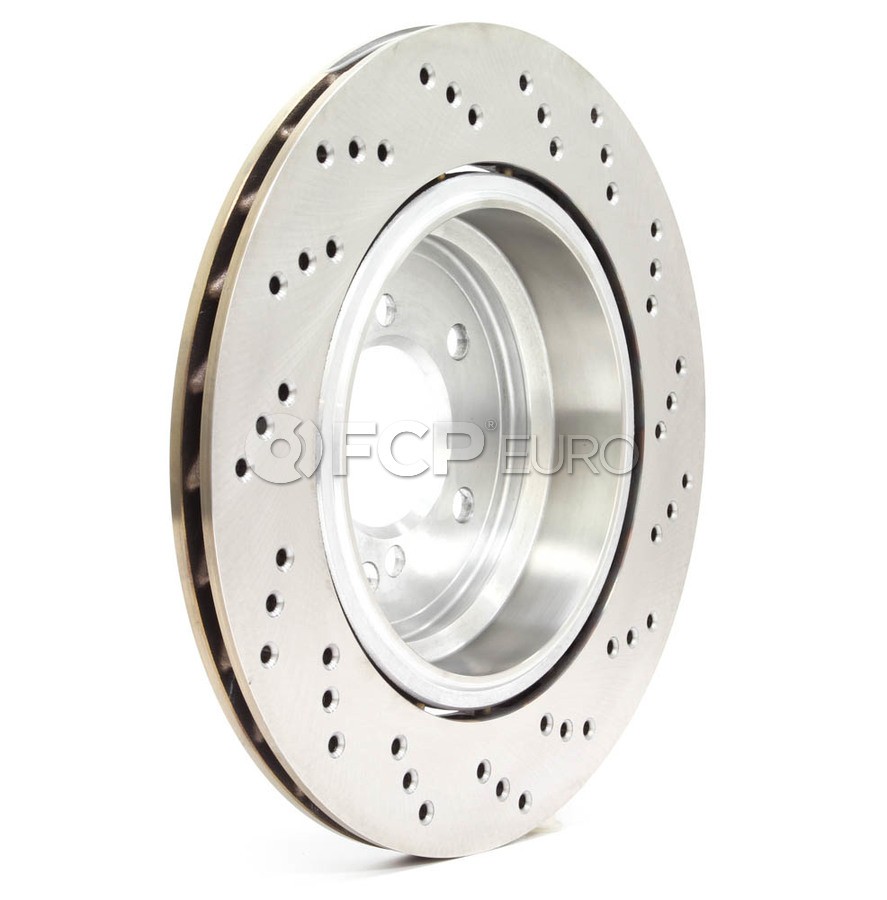

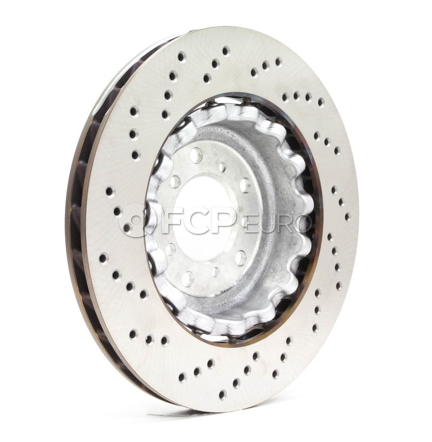

                        It's due to the hat design. The way it's cast makes it extend into the air inlet of the rotor vents, blocking a lot of airflow:
                        Click image for larger version  Name:	open-uri20150527-20723-20i3eg.jpg Views:	0 Size:	93.2 KB ID:	233481

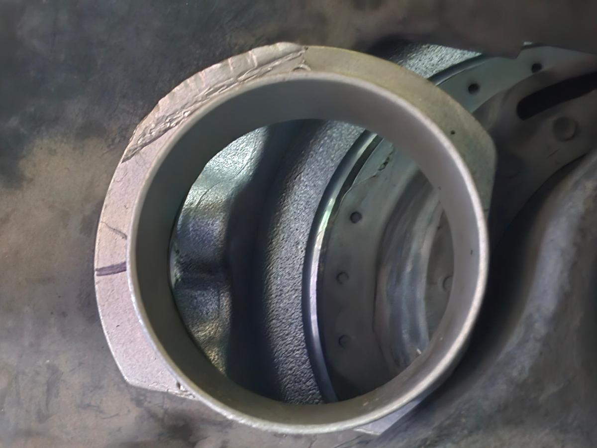

                        This is what my brake duct outlet looks like now. Pretty apparent that a lot of the airflow is blocked by the hat:
                        Click image for larger version  Name:	20230827_152624.jpg Views:	0 Size:	86.2 KB ID:	233482
                        The rears are even worse (but not as susceptible to overheating):
                        Click image for larger version  Name:	open-uri20150527-20723-1xwfez9.jpg Views:	0 Size:	83.2 KB ID:	233483
                          ^ Interesting. Thanks, heinzboehmer.
