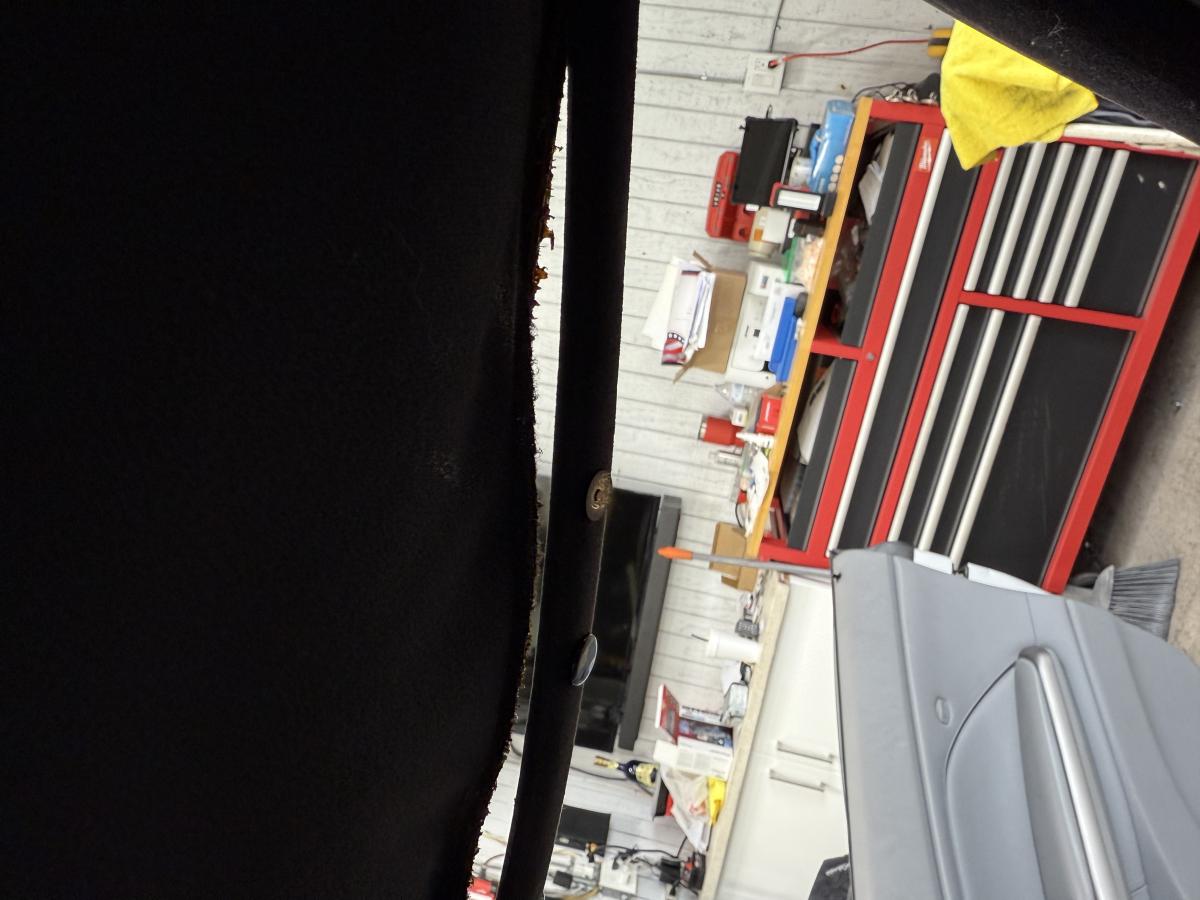

    Does anyone know where I can find replacement headliner door trims? The current ones on my E46 are spent after the original owner did a slipshod DIY headliner replacement. I got a new headliner installed however the upholstery shop I used couldn’t replace them and just glued the existing ones back on.

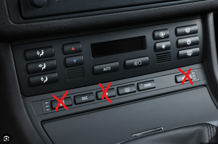

                  Anybody can help me find that PN for this module ? without heated seats and HK button. thanks in advance !!
                    I don't know this for a fact, but it may point you in the right direction. I believe that these are made to be fairly modular. The base of it seems to act like a modular cage so you can add and remove switches/buttons. The face plate comes off the front which allows access to the switches.
                    My gut feeling is that you can do this:
                    buy a switch panel that has 3 buttons on it. LINK
                    remove/steal the face plate from that one
                    remove the face plate from your factory one. remove the switches you don't want (LINK showing the guts)
                    re-arrange buttons to your liking
                    install face plate from the second switch panel you purchased LINK
                    code??
                    Maybe someone else can chime in on this.
                          code??
                          My understanding is that this was the case in earlier manufacturing years (you can actually see on early model cars that the panel face plate is segmented to allow additions/removals. BMW then changed to have different part numbers for each combination of buttons with a single faceplate. Subsequently I believe they discontinued these and if you buy one today it has all the buttons and you have to put blanking caps over the buttons that don't apply.
                          If you have a latter year car I believe the only option is to find a second hand module in the exact configuration you're after. If OP has earlier model year and thy can source the switches they need they will be able to do as you say.
                            The late style switch center is still (sorta) modular: https://nam3forum.com/forums/forum/m...087#post246087
                              ah good stuff - thanks for that clarification. So theoretically all you need is one that has all the buttons, take out the ones you don't want and face plate to match.

                                ahh yeah it makes sense ! Mine is a ZCP 2005 with manual non-heated seats, no HK so it's suppose to have only 3 buttons from factory but I guess last owner changed it and it has the full 7 buttons now, even for the rear sunshade. I guess I just need the cover plate letting 3 holes for DSC, tire pressure, Sport.
