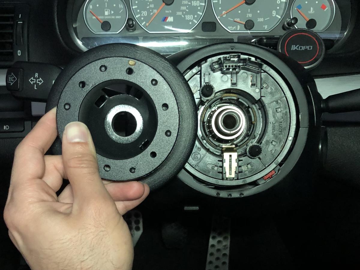

    I think you will need to recalibrate it to learn its zero position. The SCCM also is used by the DSC, the car will see an unexpected angle versus yaw and wheel speed..
    also it will spin more to one side on lock to lock conditions so you need to make sure there is enough cable inside the spool. I think it does as the angle is not that much but not sure how much slack there is. Record the position and spin it in both directions to see how much there is lock to lock, be careful as there is no mechanical stop other than the internal wiring. As long as there is enough rotation based on the cars lock to lock turns based on the steering column limit you will be fine.

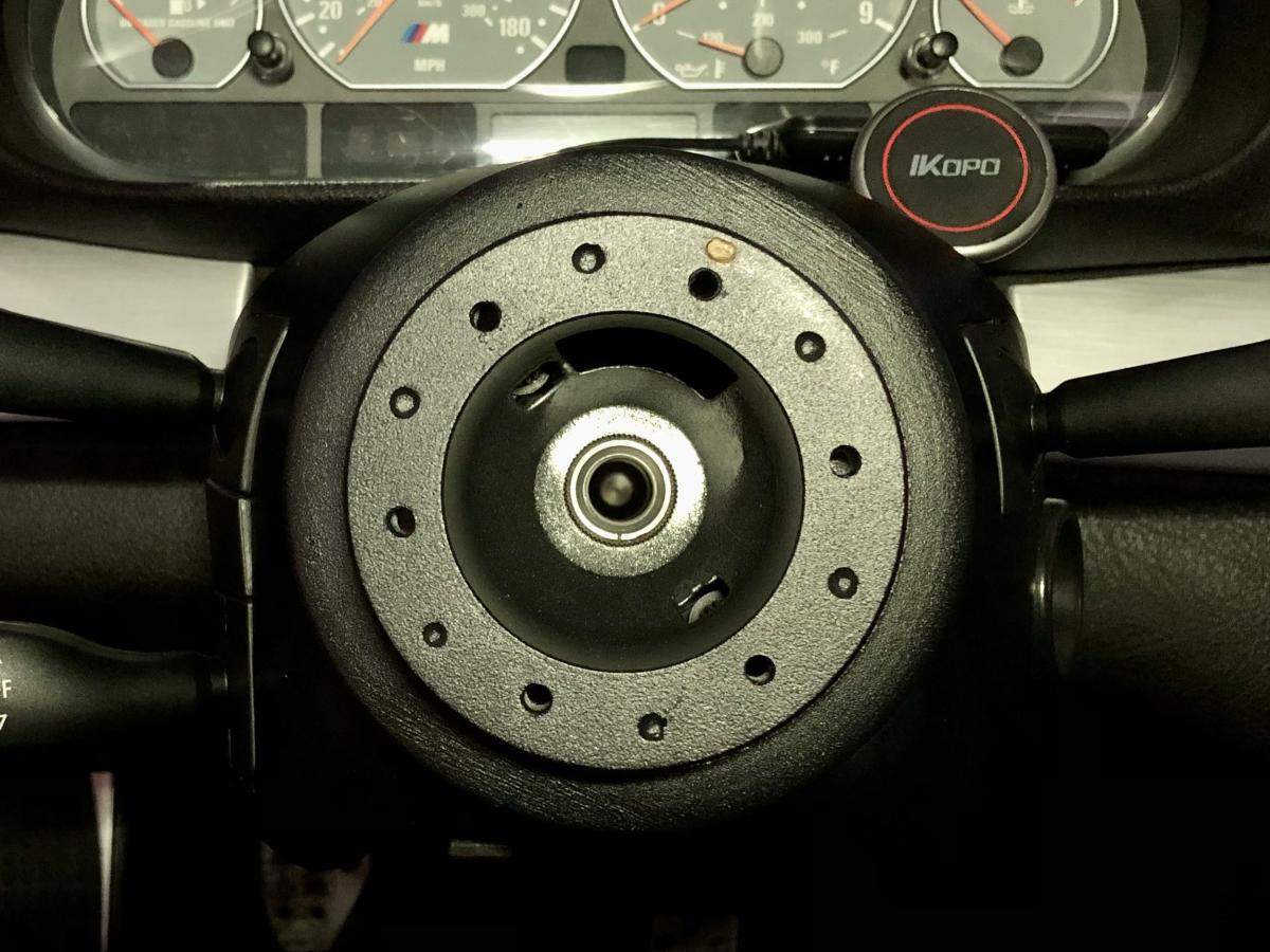

    Damn didnt even think about the DSC and yaw sensor! Yeah now I'm not sure what to do, i really dont want to drive with a crooked steering wheel, and this doesn't seem like something an alignment would fix? Not that i have time before a 3.5hr drive up to Sebring Friday for a track weekend.
    Here’s how crooked the hub and wheel would be if i put the hub on with clockspring centered (top hole has gold mark)
    Ugh, why couldnt OMP just make their wheel hub have the holes for the clockspring knobs and the top wheel bolt hole be centered correctly lol. In an install video on youtube someone used a NRG one and they were able to slide it on centered no problem with the clock spring in center position. Figured a ‘quality’ brand like OMP i wouldnt have issues like this

      You can drive it, but would get DSC/ABS errors. Or if you have INPA I think you would be able to zero it out. It needs to learn its zero position.
        Position of the clock spring won't affect the steering angle measurement. The sensor for that is further down on the column and the column and clock spring are not mechanically attached by anything other than the steering wheel.
        As Mau said, if you've got enough slack in the clock spring to be able to turn it to full lock both ways without it binding, you should be alright.
          Oh ok awesome, good to know and thanks for confirming that! Yeah was really worried about having any DSC/ABS issues before a Sebring trip so already had given up and was packing up the wheel hub to return it to the local OMP America store I bought it from. I reached out to the sale rep too with the issue and he said hes going to check if there was a revision but I'm not hopeful. Said hes seen a similar issue with their NA/NB Miata wheel hub.
          I guess I’ll go ahead and install it then with the clockspring canted to confirm no lock to lock issues, but will most likely do it after the Sebring weekend trip to be on the safe side and can test it properly. Dont want to discover issues while so far from home. Will follow-up with the results.
