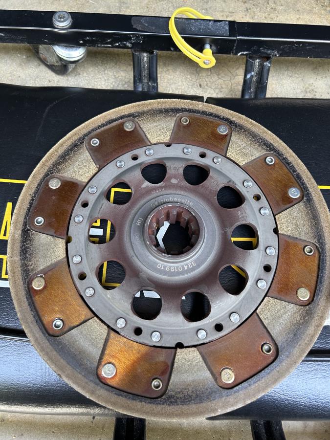

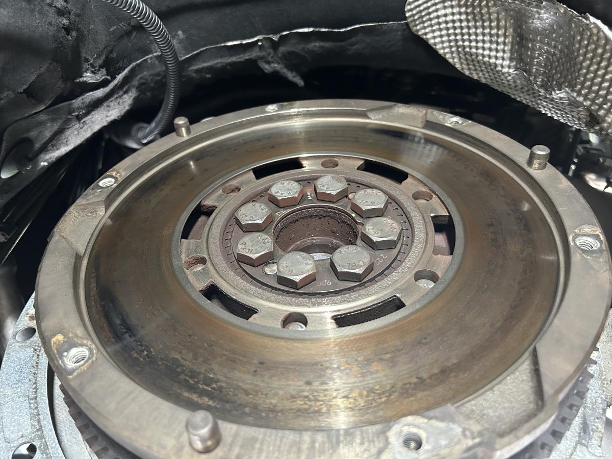

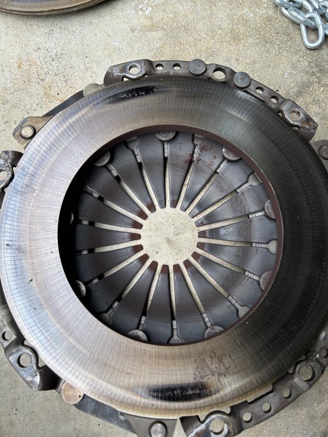

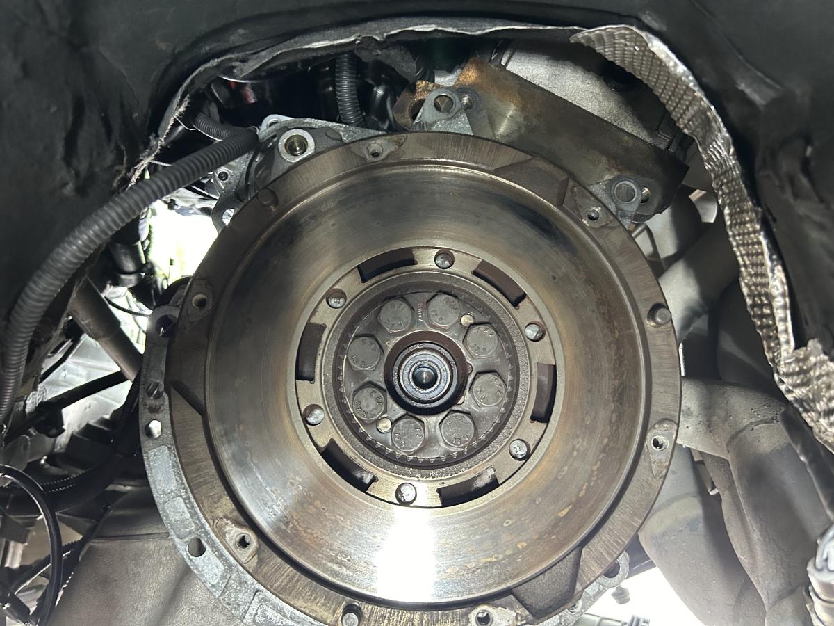

      Finally got the pressure plate bolts off. Attached some pictures of the flywheel and clutch. There's about 30k miles on the clutch (including many track days) and the flywheel is original to the car (2002). Have been getting some strange noises (high pitched squeal) randomly while shifting so pulled everything to take a look. Clutch is getting replaced. Thoughts on reusing the flywheel? Black marks on the clutch, pressure plate and flywheel all match up. Running a fingernail over the flywheel doesn't catch anything. The insides of the flywheel feel "grainy" while the outsides are smooth. Normal wear and tear or something wrong? Been a long, long time since I replaced a clutch.
      The piston for the slave cylinder popped out; push it back in or just replace?
        SPEC clutch? Throw that thing in the trash, if you are N/A get a stock clutch kit. IF the flywheel isn't grooved its likely fine.

        The piston for the slave cylinder popped out; push it back in or just replace?]
        FTE slaves are cheap, but if the current one looks fine reassembling it shouldn't be an issue.
          Thanks George! Car is N/A - going with Luk clutch kit plus OE pilot bearing. Any need to replace the clutch fork and spring clip "while I'm in there"? Already have a metal pivot pin.
