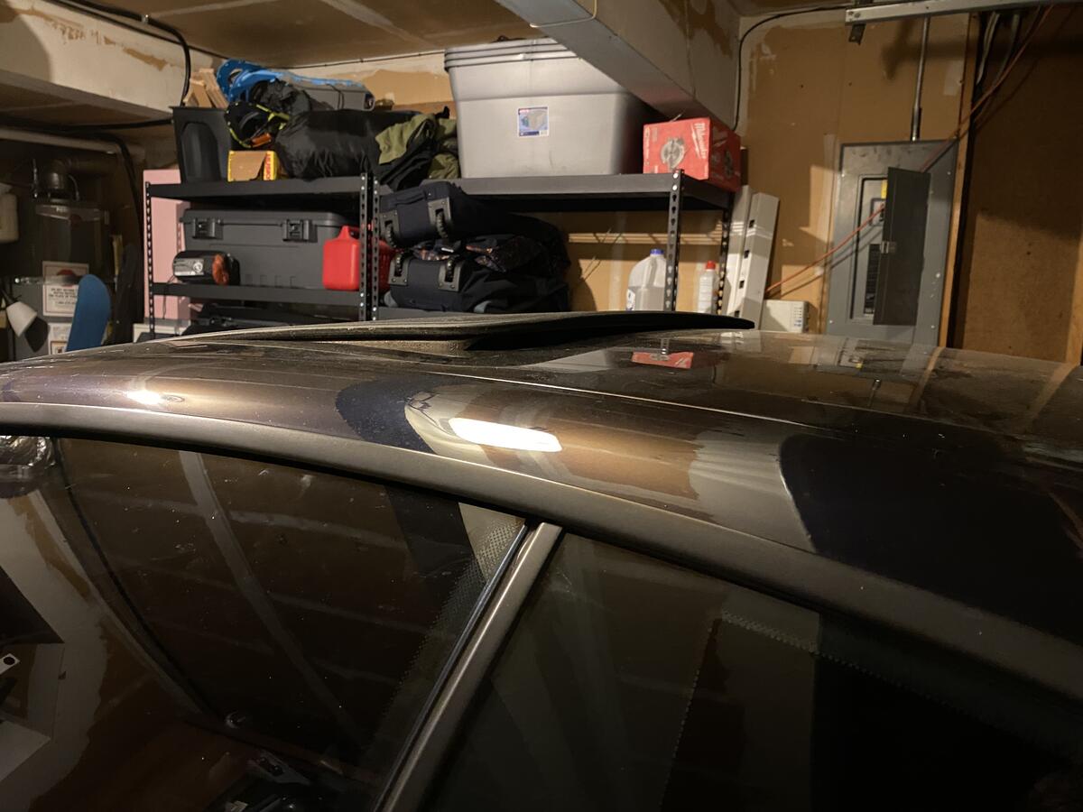

                My sunroof is quite busted, picked up the car this way from the PO. When I operate the switch all that happens is a horrific gear grinding noise with no movement whatsoever in the glass. I understand that I’ll likely need to do a full rebuild depending on how busted the gears are. My question does not have to do with repairing this, I can find plenty of DIYs for that.
                The issue I’m trying to solve is that the glass was positioned in the slightly open elevated position directly before becoming permanently stuck. Before I take the glass off to do a proper inspection, does anyone know if I can reposition the track/mechanism to allow the glass to sit flush with the roof prior to addressing the core problem more holistically? I haven’t decided if I’d rather do a full sunroof rebuild or a CF roof conversion, however while I sort that decision out longer term, I’d like the sunroof to be fully shut. Any tips or guidance on how to lower the glass with gears that are fairly binded?

                I wonder if you're get better results with using the manual closure method. There's an allen key that should live in the trunk toolkit, but this video just uses bits from a more generic toolkit: https://www.youtube.com/watch?v=vO6t9s7bZHs
                The sunroof in my E39 is almost equally busted, and while the motorized mechanism won't do it, I can still manually close it with this method. E46 and E39 use identical motors AFAIK.

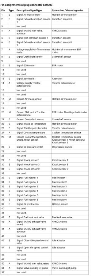

                            does anyone have a photo of a stock MSS54 non- HP X60003 gray connector I can use as reference? I probably should have taken a photo of it before I started messing with the pins lol

                              ​​​​For some reason pin 19 shows as not used on TIS, but it's definitely there. I think it's a 5V reference for the TPS? Can't remember exactly
                              I also do have pics of the connector if you really want them, but it's wired for a MAP sensor and CSL IAT, so some (5 or so) pins will be different to stock
                                heinzboehmer much appreciated. That's all I needed.
