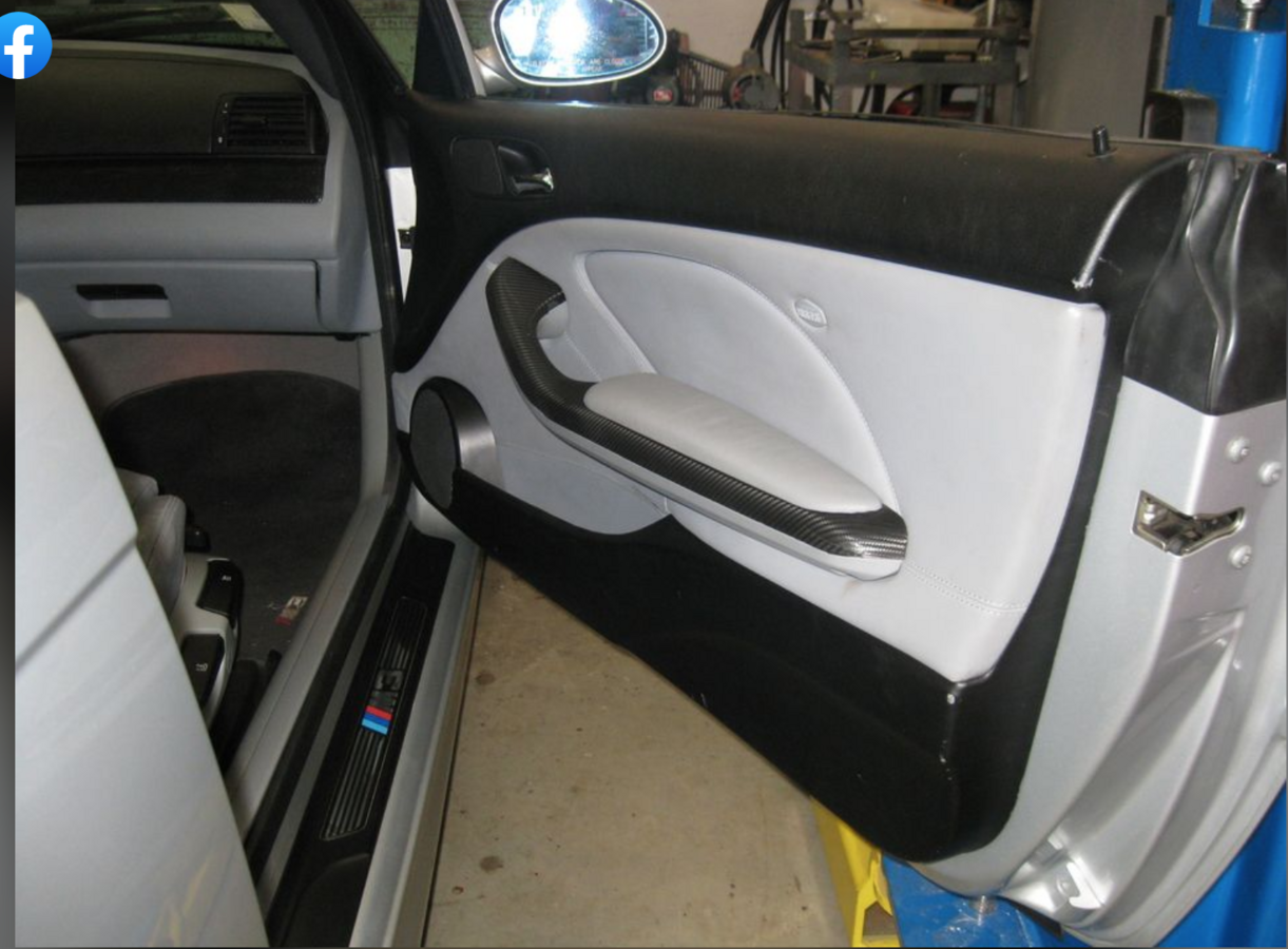

                              Didn't want to create a whole thread for this but I wanted to do a pic request on a full black interior but still keeping the grey dash. I wondering if it would look goofy if I swapped everything except the dash.
Name:	Screen Shot 2021-01-28 at 5.40.44 PM.png
ID:	97136 I saw this on FB Marketplace a few months back and I'm thinking with black carpet and black seats it could look pretty good.
                                Grey and black go together like peanut butter and jelly and while it obviously won't be factory if what you are moving to is in vastly superior condition then it will be a win.
                                Here is a pic where I'm currently moving to Imola but not swapping the dash. It will look great IMO and the reason I'm not touching the dash is because it is immaculate. Not a single blemish and everything else usually has problems.
