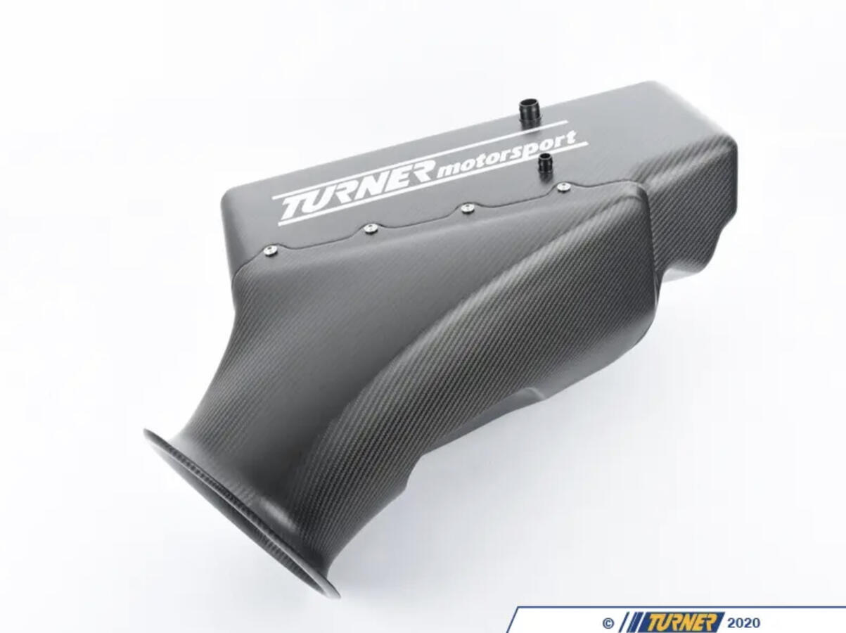

      after I install a CSL airbox can the car be driven about an hour to the tuner/dyno? I am sure it will throw codes but will it damage anything? thanks​​​​​​​Click image for larger version

        Yes. You will get a check engine light because of the missing MAF sensor but the engine will run on a backup alpha n map to estimate airflow. Just be reasonable and keep the revs low. You should also check with your tuner, they may just give you a base tune to load.
