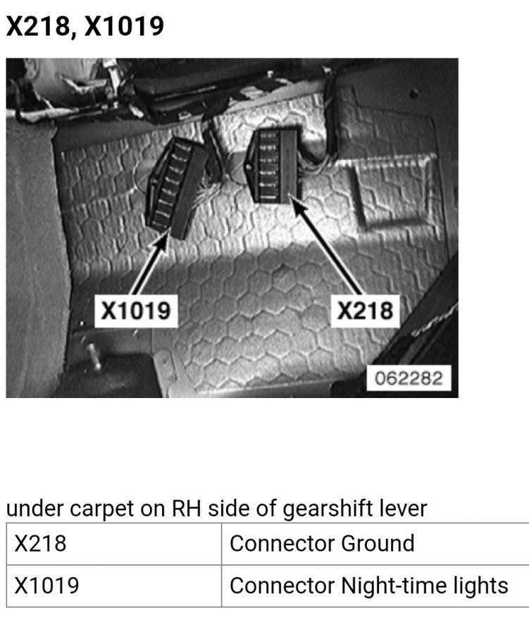

    Does anyone know what these are for? I was running through the wiring harness last night and came across these.
    They look like they just connect to other modules rather than back to the fuse box. Sit along the pass side of the trans tunnel (interior)
    04 SMG Coupe
      Looks like X1019, no?

      If so, it's just a distribution block for the nightime interior lights. LCM drives it high when headlight are on and all modules connected to it use it as a signal to turn on ambient lighting.

        That is exactly it. Actually had a question for the other one next to it as well.
        Thank you! Where'd you find this info at, need to expand my library of resources.
        Assuming this is just a LCM accessory piece then I should be good stripping it out? Currently combing through my wiring harness for the track car.
        Edit: Logged into Tis and started looking up the wiring diagrams. X218 seems it may be a little more complicated than just cutting and thinning wires. Most likely will just end up relocating this

          Yep! Info came straight from TIS.
          If you don't care about having backlit buttons at night or anything like that, then yep you should be good to just rip out the distribution block and remove all the wires that go from it to the different modules. X1019 wiring diagram in TIS can tell you which modules you need to remove the wires from.
          Yeah X218 will require a bit more work. That's a ground post, so you should only remove any ground wires that are for modules that are no longer present. I don't remember all the details from that area, but I think X218 isn't grounding to the chassis and instead just acting as a ground distribution center. There should be another ground post nearby that is both connected to X218 and the chassis, but you should double check as I might be misremembering.
          Anyway, point is that if X218 isn't directly connected to the chassis then you should be good to relocate it​

            You're spot on again. I was digging into X218 and saw it was just an extension. So I can Atleast get that part a little cleaner/less rats nest.

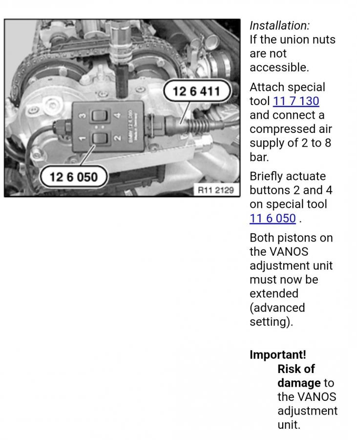

                What is the purpose of this tool? BMW VANOS Switch Adapter Lead - Genuine BMW 83300491148...
                  Hah! I too saw that in the clearance email a bit ago and wondered the same thing. Subscribing.
                    Lets you actuate the VANOS solenoids so that you can extend/retract the pistons with compressed air. It's featured in the timing procedure on TIS.
                    The one in the FCP link looks a little different to the one in TIS. They probably just updated the design over the years.
                    Click image for larger version  Name:	Screenshot_20231122_004119_Chrome.jpg Views:	0 Size:	71.6 KB ID:	243060
                    Edit: Actually, I think I'm wrong. The tool I'm referencing is another special tool (11 6 050). This one (12 6 412) looks like it just provides power to 11 6 050. See here: https://www.turnermotorsport.com/p-3...anos-tool-kit/
