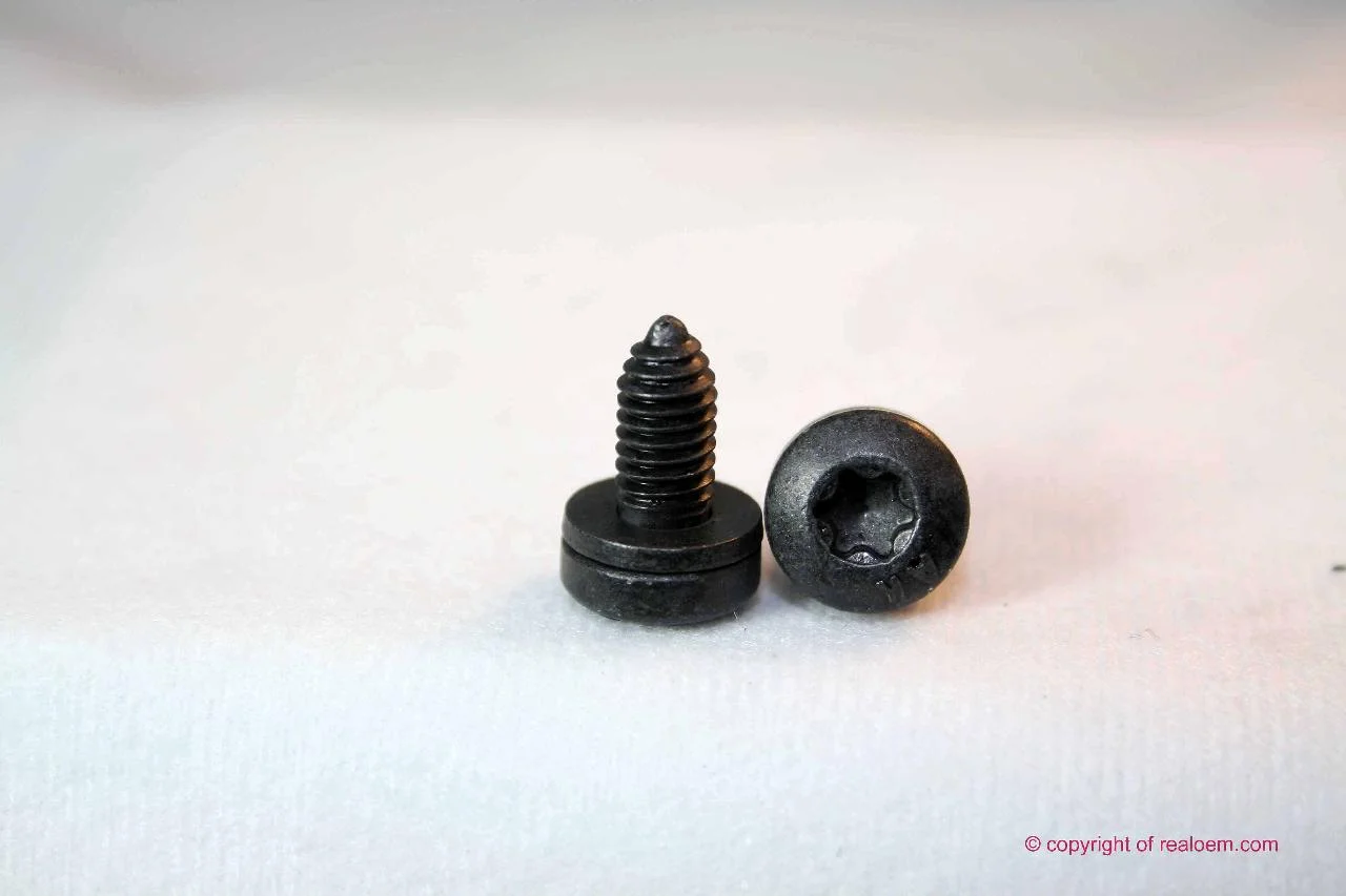

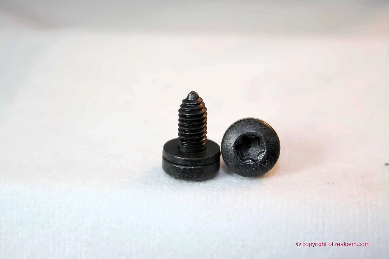

        Attempted to replace my trunk lock actuator today. Factory BMW part, and the bracket holes aren't threaded; TIS says use self tapping screws. Looking at how this part fits, I get the self tapping screw requirement. I'm thinking that the 3x T30 M6x12 bolts originally holding the actuator in can be re-used (those aren't self tapping) once I run self tappers through the bracket with the actuator in place? Sometimes I wonder how they built this car. The actuator has no physical datum to the trunk that I can see. Seems I would just set it in place, aligned it as best I can using the oversized holes in the trunk and just slam home the self tapping screws? I'm not dumb, I swear...
        Original bolts: 07146985055
        EDIT: Me thinks I should have ordered brand new screws as the original is in fact a thread cutting screw.

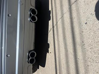

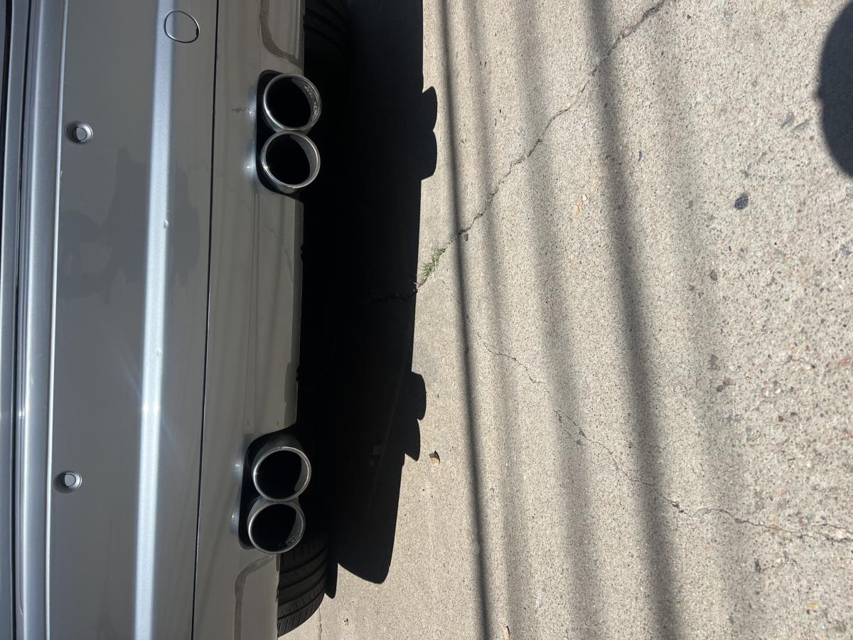

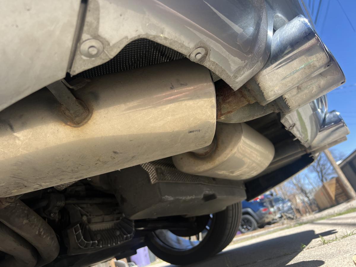

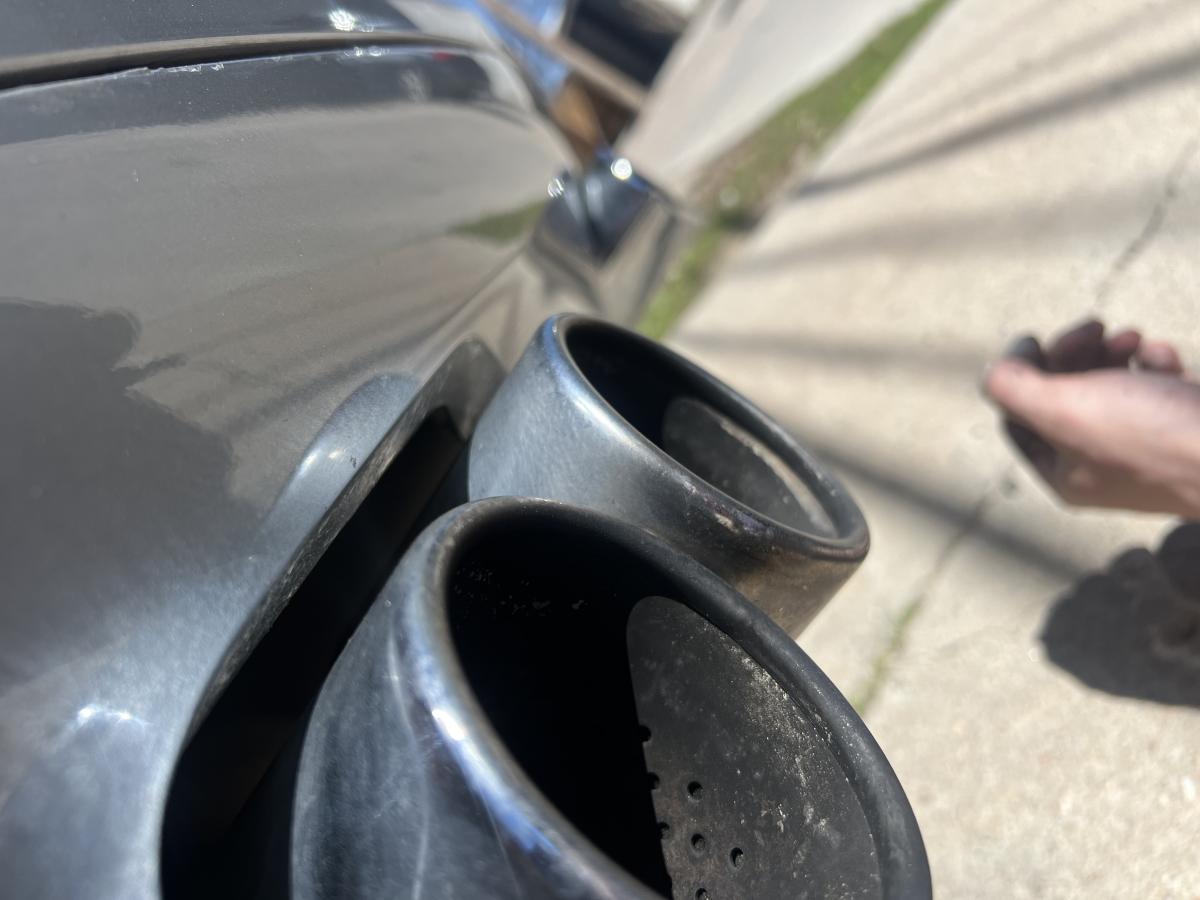

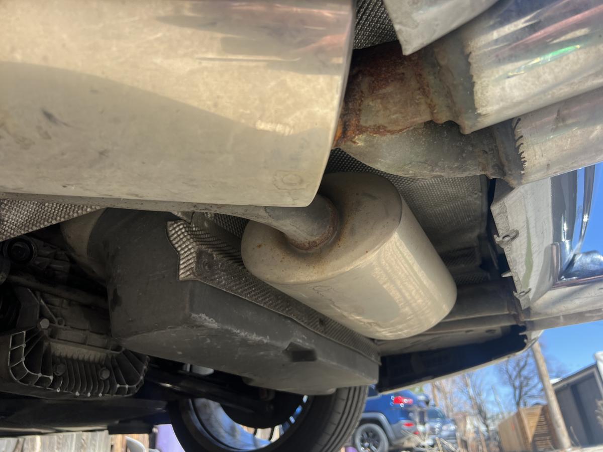

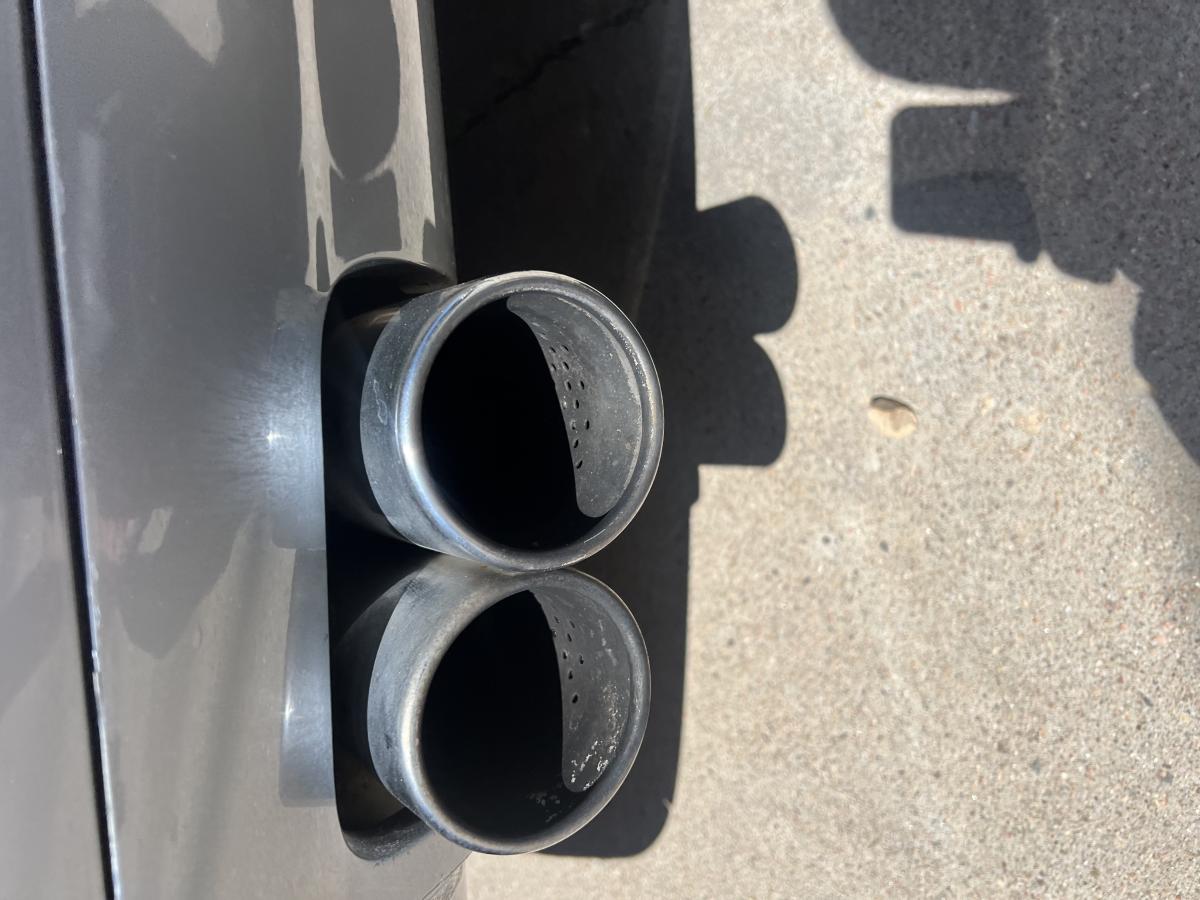

                    Anyone able to identify brand on this ? I’m not seeing any stampings on it.

                      Looks to be custom. Couldn't even match it to anything on the definitive exhaust guide, listed below. Definitely a copy or an attempt to be similar to the other popular ones.
                      I've been fascinated (or at times disappointed) with the various exhaust options available for the E46 M3, and at times obsess over the various details of the construction of the available systems. However, through this I was able to learn a lot about the available exhaust components for the E46...

                          I couldn't find a good match either and got to the same conclusion. I hate not knowing lol. At least it sounds good though, so I'll get over it.
