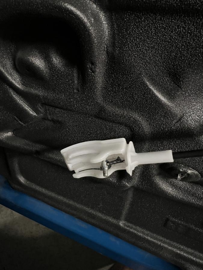

    It kind of just clips back on from what I remember. If you only did one side, it could help by removing the other side and seeing how itโ€™s clipped on there.
    Thanks I must be overthinking something. When I clip in the white housing the latch doesn't seem to be grabbing the cable upon pulling the door handle.

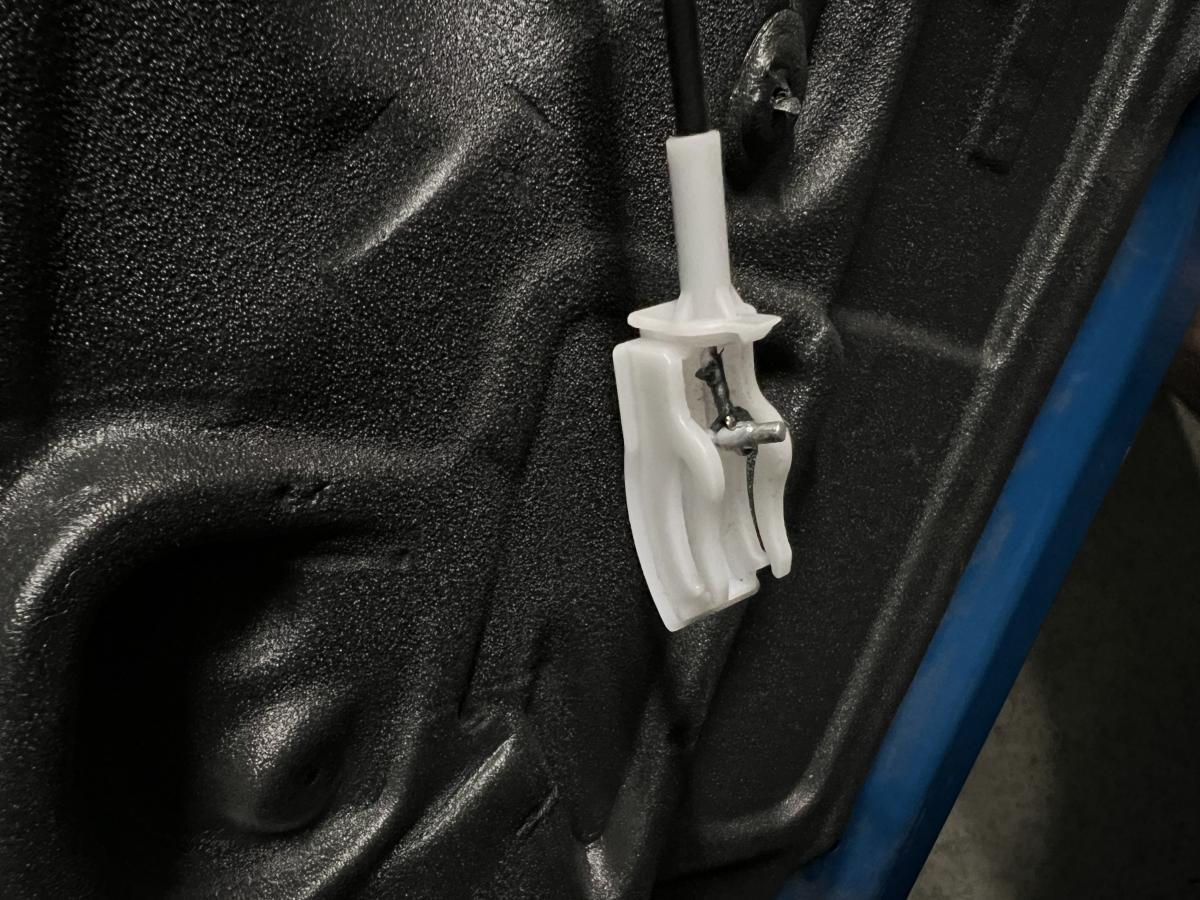

      Ok figured it out. The cable needs to be seated inside the two little gaps then they'll act as rails.
      Mine(as pictured) came unseated on removal.

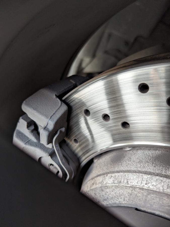

                          Can I get brakesperts opinion please? On the right side when braking I get a little squeak, I brake long, soft, and slow not hard it's just a daily driver. To me there's enough pad and rotor but I'm not sure if I need to replace them or not. Pic for reference.
                          Click image for larger version  Name:	PXL_20240317_233411520.jpg Views:	0 Size:	60.0 KB ID:	257957
