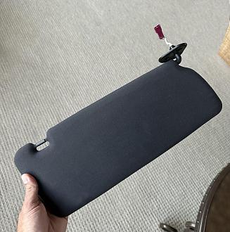

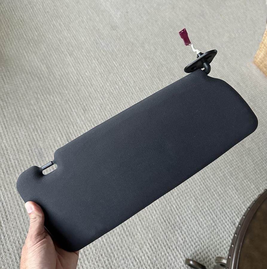

        YMMV but this "technique" ruined my good condition visors and left sticker residue all over them. Once the sticker falls apart when peeling, it's nearly impossible to make it look good.
        Vert visors don't fit. The best plug and play alternative is vinyl sedan visors with the mirror light. I imagine the adhesive is easier to remove from vinyl as well. E36 coupe visors have the screws and tabs in the correct place but idk about wiring for the lights. All the euro stuff comes without a sticker. I picked up a set on ebay to replace my goo'd ones
        I gave this a shot last night and used 91% isopropyl alcohol that came in a spray bottle. It took a few passes and a few different brushes to scrub it out gently but I got it. Sorry to hear the goo gone didn’t work - I was concerned about the oily residue and opted not to go that route. The IPA was tough on the sticker but gentle on the fabric and evaporated quickly once it was done working.
                  No worries. Just a warning for other folks.
