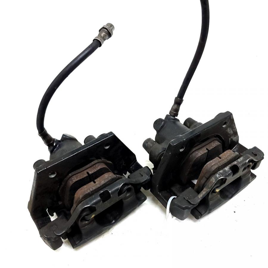

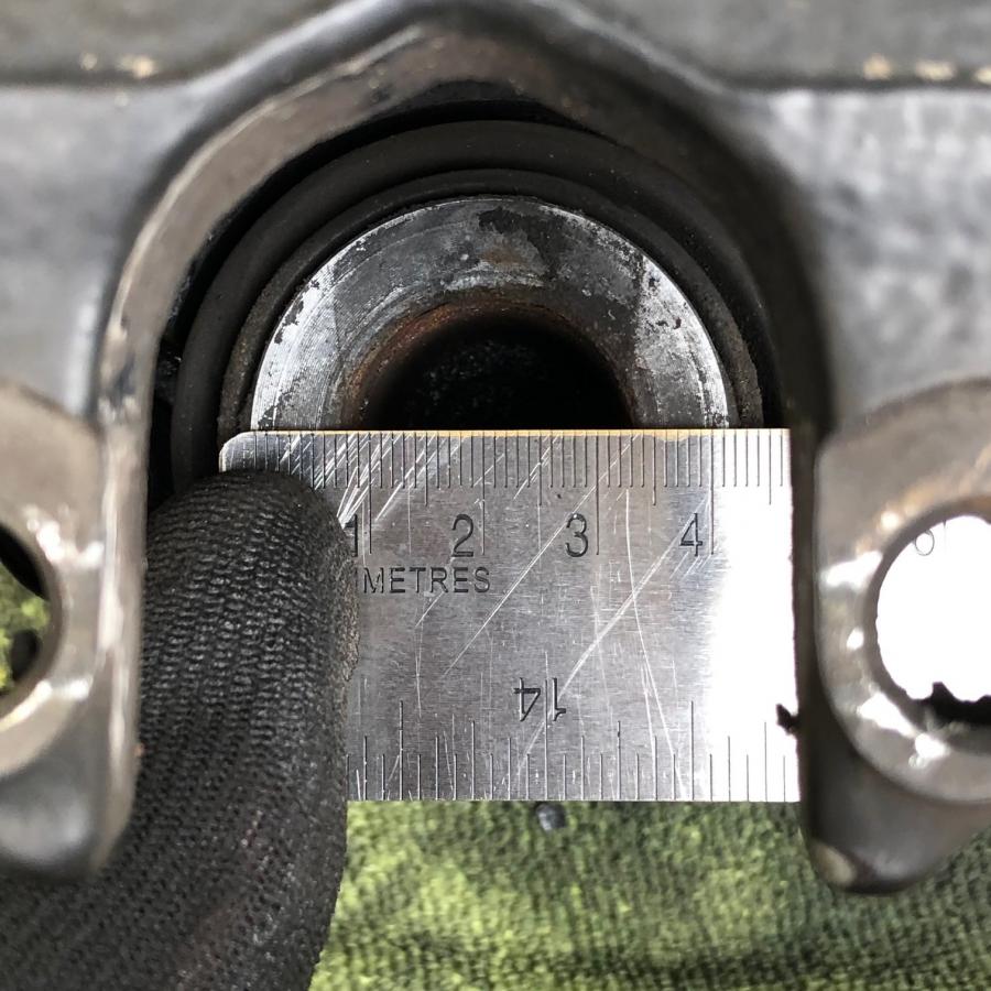

    Do all E86 (2006-2008) Z4Ms have the same rear brake calipers as a ZCP/CSL E46 M3? i.e black calipers with 46mm pistons (vs standard M3 42mm)? This is what I had read and researched looking to upgrade to ZCP rear brakes, but I just got a set of rear calipers from a 2006 Z4M I bought on eBay and the pistons are 42mm (pics below)... look exactly the same as my standard 2004 M3s rear brakes...
    So is it just some years of the Z4M or did this seller screw up? I figured maybe they sent me standard M3 rear brakes, but the carriers/brackets seem to be different from the E46 ones and the brakes are painted gloss black... (third pic is from ebay listing showing carriers and complete brakes)

      Do all E86 (2006-2008) Z4Ms have the same rear brake calipers as a ZCP/CSL E46 M3? i.e black calipers with 46mm pistons (vs standard M3 42mm)? This is what I had read and researched looking to upgrade to ZCP rear brakes, but I just got a set of rear calipers from a 2006 Z4M I bought on eBay and the pistons are 42m... look exactly the same as my standard 2004 M3s rear brakes...
      So is it just some years of the Z4M or did this seller screw up? I figured maybe they sent me standard M3 rear brakes, yet the calipers came with very different carriers/brackets from the E46 ones and are painted gloss black...

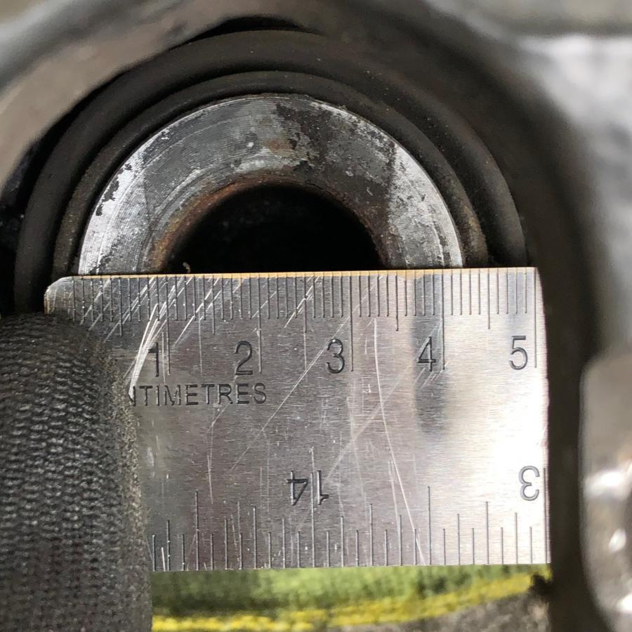

      I purchased a set of FR/RR Z4M calipers w/brackets earlier last year and rebuilt them with the same upgrade intent; I found the rear pistons to be 46mm as evidenced by the rebuild kits I used. So, maybe your seller did in fact make a mistake.
        Thanks for confirming! Yeah I was confused cause initially I was certain the carriers they came were not from a E46, but checking some pics online seems they could be E46 M3 rear carriers. That along with them being gloss black with the //M embossing really had me scratching my head what these are from at first though. So yeah I'm pretty certain now these are a regular E46 M3 rear brakes and a previous owner did a really good paint job on them.
        I already contacted the seller telling him these are incorrect and not from a Z4M, hes going to check for the correct pair and if not I'm returning.

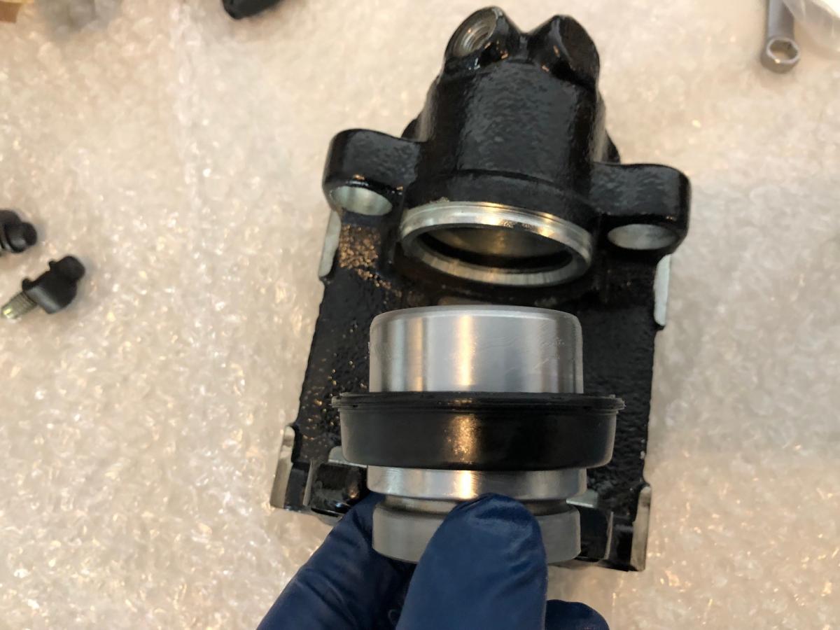

          One way to tell, if I recall, is to look at the dust boot. On the ZCP/Z4M/CSL w/46mm piston, the boot is a press-on type with integrated crush ring as opposed to a somewhat "insert fit" (same as front caliper dust boot--it just fits inside a circular profile on the caliper housing--easy install) on the 42mm standard caliper. If you tear into a set to rebuild and need some insight, feel free to IM me I rebuilt the front and rears and learned quite a bit. The rear ZCP caliper boots require a knack and "special" tool (in my case, a cut off shop vac attachment) to get that boot on--but you only get one shot. I had a thread on here with my rebuild but haven't updated it--I probably should. Below is a photo of the ZCP/Z4M/CSL boot I'm referring to...
            Click image for larger version  Name:	IMG_7335.jpg Views:	27 Size:	92.2 KB ID:	202991
            Awesome stuff, yeah that was the one thing I was looking at in pics to compare the two caliper types, the thinner looking seal on the ZCP/Z4M's bigger diameter 46mm piston. The seal looks thinner and closer to the caliper housing bore compared to the double lip look of the standard 42mm pistons, so thanks for confirming that! I am actually looking to rebuild a spare reman front brake caliper with new ATE seals as a project, so I will def hit you up if I run into any issues with that.
            I'm convinced these eBay rear brakes I received are from a standard E46 M3 and a previous owner of them just did a good gloss black paint job. Dunno how the seller mixed them up as being E86 Z4M ones, but they seem to be a big junkyard business account so happens I guess. (pics attached from the ebay listing)

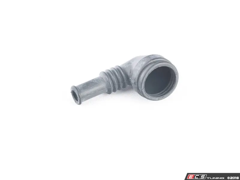

              I'm a part finder extraordinaire.
              That is to say, I don't remember
              Probably looked at all the images of electrical grommets/insulators in realOEM, and tried various part numbers in google till I found the one that looked most like the one we all have (right side). Ordered it, and it fit.
              Yep. BTDT. Got a t-shirt perhaps somewhere.....
              Mike
              02 M3 Titanium Silver / Black
              11 Tundra SuperWhite / Black
                Originally posted by BMWE46M3 View Post
                There are two plugs that insert into the headlight control module as shown in the attached image. One of mine has a rubber grommet over it (Part # 12521737944) as shown in the image below, but the smaller plug does not have a rubber cover. I would like to buy one and it appears to be different from the one shown and I can't seem to identify the part number. Does anyone know? Thanks..
                Fun fact. Some cars had the cover installed; some did not. No rhyme or reason why. It drove me nuts so just like Tbone I found the correct part number (his is correct).

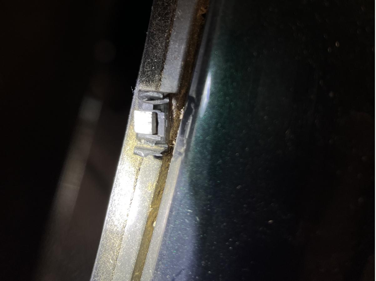

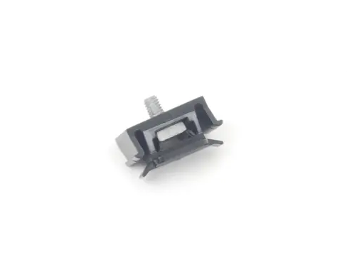

                          Long shot, but anyone know how to remove the trim clips for the trim around the hardtop on a convertible? Have to assume it pries straight out given the square head, but I found the new part on ECS and it looks threaded. Figured I'd ask before I break it considering the stupid high cost of every trim piece on this thing. Trim removal on the coupes doesn't seem to be the same from the videos I've found.

                            nevermind, figured out they're threaded and held on from the back by this little round nut #54218270150​.
