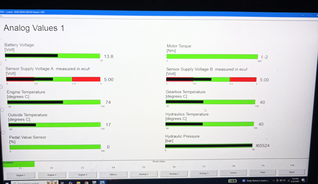

                  Looking for some help, just bought a 06 SMG vert that had the SMG pump replaced ~2 years ago (~2k miles ago). Car drives fine, but recently got the gear cog and INPA says that it's got Fault 35: Auswertung Hydraulikdrucksensor, showing -12.5bar when car is off and !65524 when car is running. Any ideas on what to check? Sensor/wiring comes to mind, but wondering if there's anything I need to consider?
                          Pressure sensor on the pump may have died, or as you noted, wiring is somehow compromised. However, if that is the case, then the pump probably should either run continuously or not run at all. Both are bad. Although I suppose, the sensor could be reading ok most of the time.
                          Pressure sensor: 0.5 V -> 0 bar and 4.58 V -> 100 bar

                                Thank you. Pulled the plenum and lo-and-behold, the pressure sensor connector was unplugged. Come to find that the tang/tab was broken, assuming that happened when the pump was replaced and it wasn't addressed. For what it's worth, I observed that with no pressure signal, the pump would run on a set interval to maintain pressure.
                                Anyhow, going to de-pin the connector and put a new connector on there and should be set. Appreciate the help.
