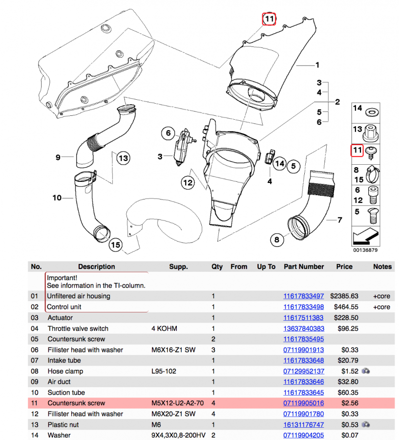

    Bought a CSL airbox and I'm missing the hardware screws to attach the base the intake. Looking to buy black screws. Is this the correct part number and hardware size?
    07119905016​ - M5X12

    So the hardware to join the two halves of the airbox?
    My Karb box came with black allen head bolts, not sure if they have a washer like the P/N you listed, but also are likely not OEM hardware.
    The bolts you listed are silver in color FWIW, you mentioned you wanted black.
    As far as the size is concerned M5 sounds right and realoem lists it as the correct part. If you want black you may need get them thorough McMaster-Carr or maybe even a local hardware store.

      Thanks for your input. Off to Ace tomorrow to see what I can put together. Airbox didn’t come with the 4 screws or the BMW M Power sticker 😂

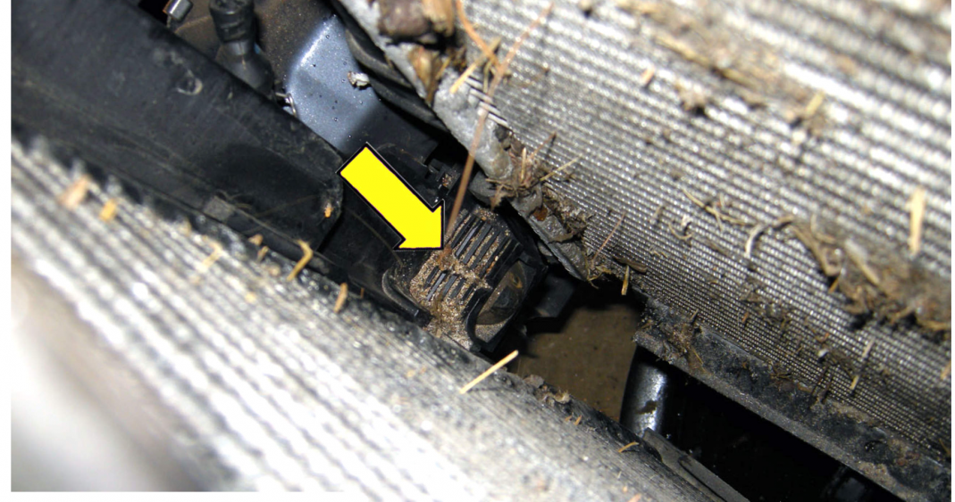

        Reinstalling the radiator after removing most of the front fascia of the car for the catcam install. Needed to slide out the rocker arm shafts etc. Now installing the radiator and I can for the fuking life of me get it to seat properly. Bottom is flush with the condenser but top side its not and its a bit high too so the torx screw holes do not mount up. I've tried moving around the rad support, unscrewing it. Screwing in the top of the rad first then trying to put the bottom (doesnt work). Just frustrated right now, I cant stand not having stuff fit perfectly back in so I gotta stop before i break something.
        Click image for larger version  Name:	image.png Views:	0 Size:	1.02 MB ID:	234146​
        Cant get it to seat there properly. Pic for reference, my shit is spotless.
        Edit: figured it out. Condenser has to lower tabs and they have special recepticles they must slot in, they're were not spotted. Was a bitch to get them in especially passenger side.

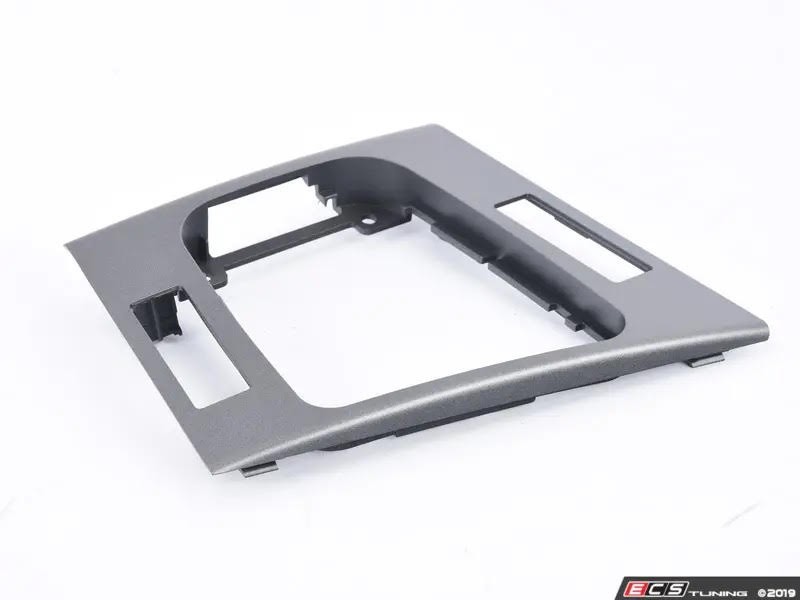

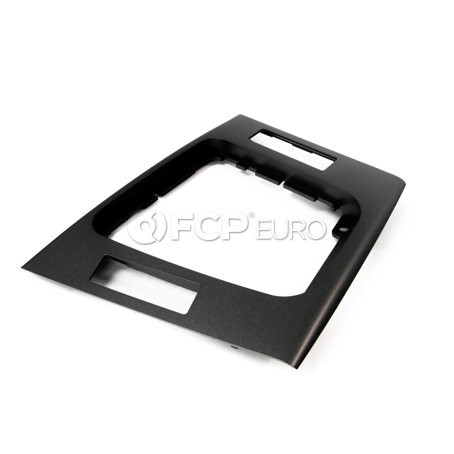

                        Is there only 1 silver interior trim color that’s not Brushed Aluminum? Are Titan Shadow and Titan interchangeable? I see some pictures of what looks like a lighter silver trim.
                          These pictures might help make my point better. Same part #. FCP's picture looks much darker than ECS's. Is this just a trick of the light?

ID:	234798 Click image for larger version
