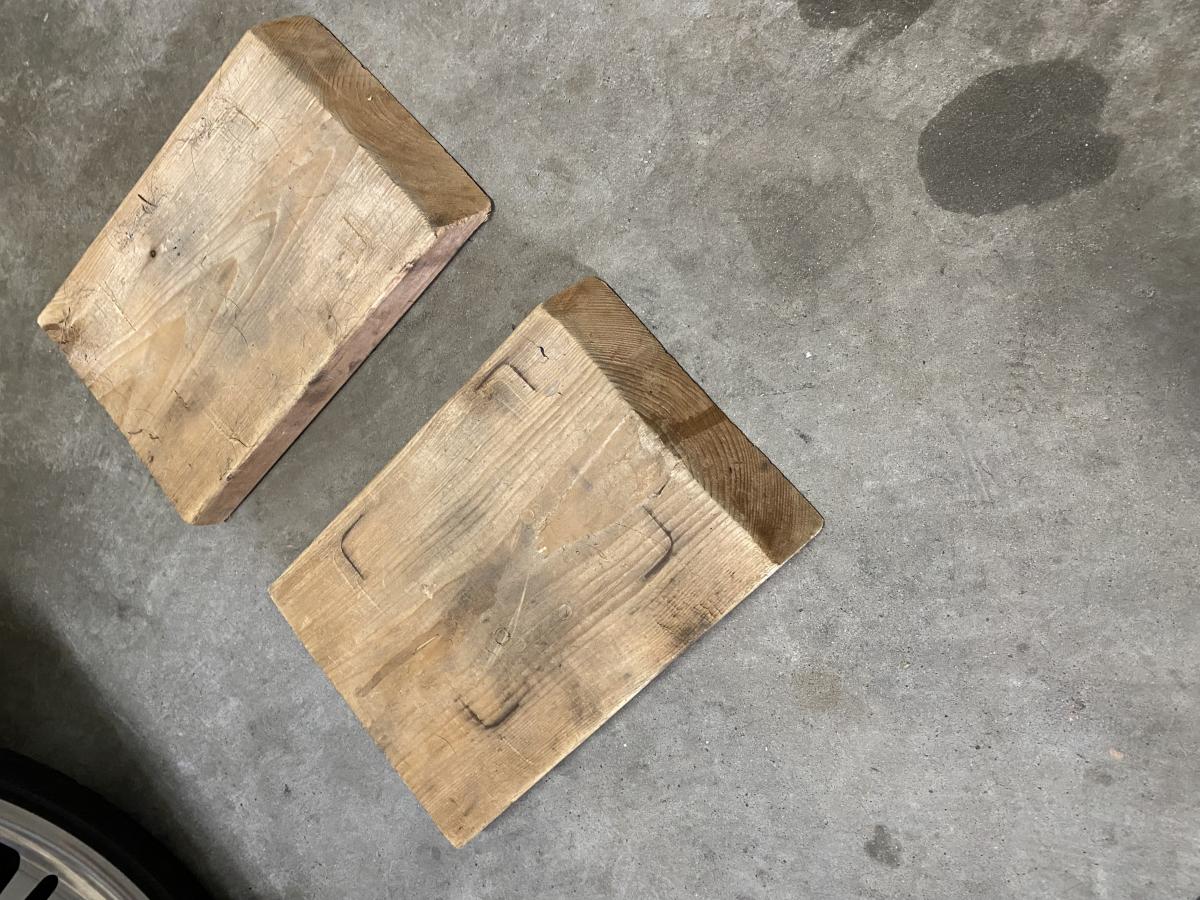

                      Definitely a a dumb question, and I think I know the answer, but I figured I'd throw it out there. I installed front aero in the off-season. My low profile jack cannot reach the hockey puck jack point at the front of the car. The typical process is wheel>wood>wheel>wood>front jacking point (hockey puck) to lift the front of the vehicle. Here is where this gets dumb, should I just get a thicker piece of wood for the initial wheel lift to create more clearance for the jack? Seems pretty simple there right? In the alternative, let's say the puck is not accessible (I honestly do not remember after installing the splitter) how do I get the car on jack stands safely (other good jack points etc. on the car?) if I cannot reach it. I've put this car on jack stands hundreds of times. Yes this is a dumb question.

                        Cut yourself some 2x10s and pull the front of the car up on them. This will give you enough room for your floor jack to reach the “hocky puck”.

                          Thanks man. I guess I just needed someone else to say it. I can adjust the height of the wooden blocks as needed.

                            I use jack A on the side jacking point and raise the car enough to get jack B on the center hockey puck.
                              Jack from the side and put tires on blocks, then jack from the front.
                              Lower profile jack, QuickJacks, low profile ramps?
