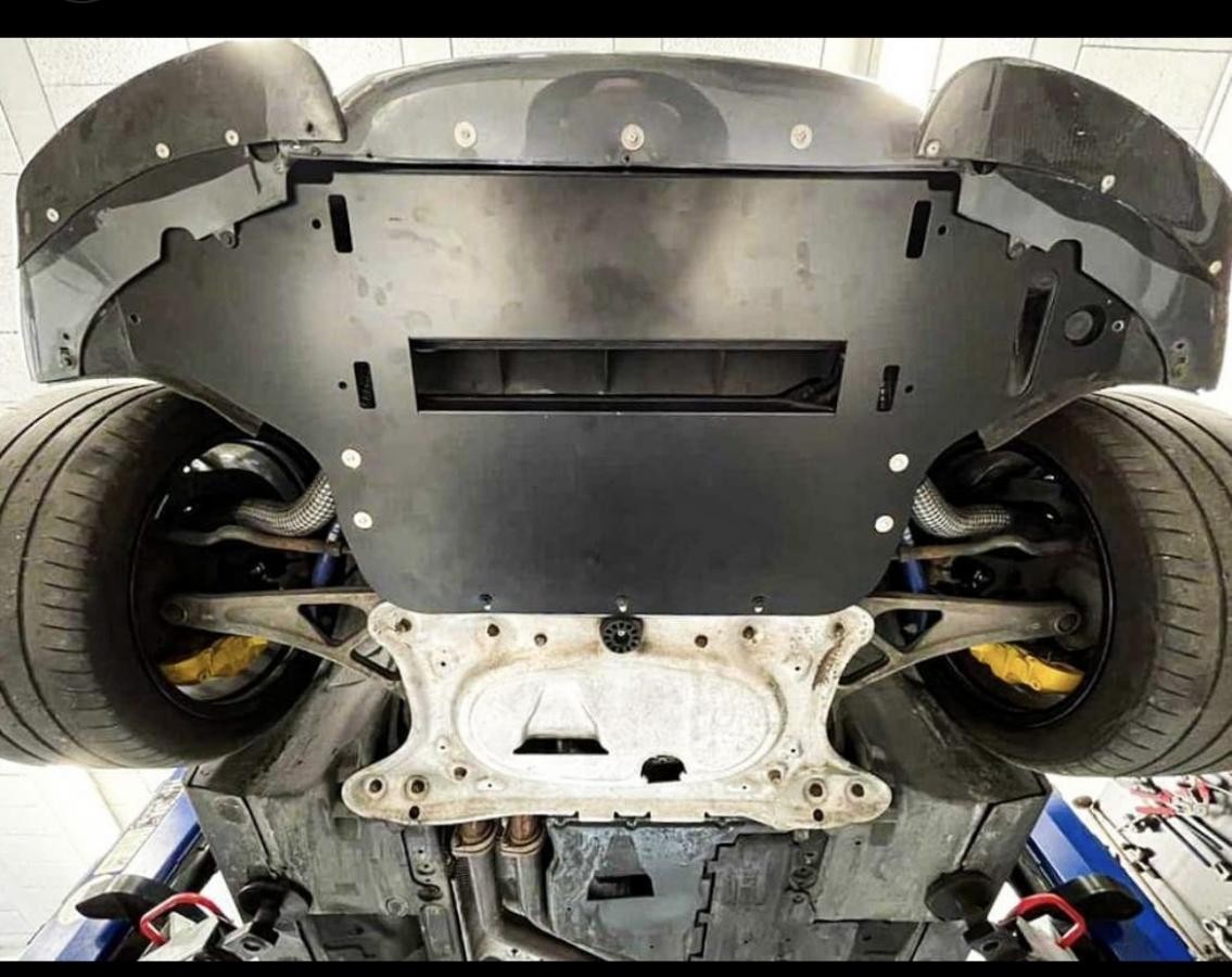

                      Is there any real point to a metal skid plate for a dual use street/track car? I've always thought of these as rally items.
                      I'm curious if there is any upshot I'm not thinking of when upgrading from OEM plastic to metal?
                      Example: https://www.turnermotorsport.com/p-4...um-skid-plate/
                        That turner one is garbage. But one like this looks like it protects more

                          Cool, good looking out.
                          So is it just more protection from road debris? Seems unnecessary unless you hit something massive 🤷‍♂️
                            IMO it’s a protection downgrade. Plastic you hit something and the panel breaks. Metal you hit something and the panels twists around and fucks up your car.
                            Unless it’s a frame mounted, thick skid plate, ala jeeps, I’d stick to plastic.
                              Obioban so the metal one that BMW put on the vehicles should be changed to plastic? I rather have a smooth metal panel underneath than the plastic hump that is OE but hey that why we have choices, to each their own
                                Stock plastic one is also aerofoil shaped. I have no empirical evidence for this, but I've always assumed it creates downforce at speed.
