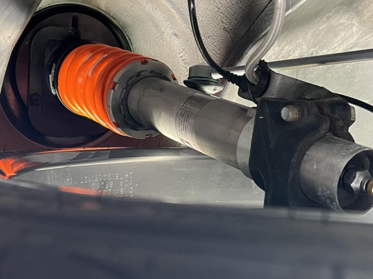

    Is this enough spring perch to tire / wheel clearance? Seems to drive around fine on the street but would rather not find out the hard way that it’s too little on track. 2.5” spring conversion + 18x9.5et35 wheels with no spacers.

          Looks like plenty of clearance to me. I wish I had that much lol.

            Thought so as well but I swear I’ve read on here others need to keep the spring perch above the tire to avoid contact with very similar suspension and wheel setups. Wonder what the difference is ..
              maybe it's a matter of preference? Having the spring perch above the tire would give the most clearance but result in using short springs.

                      So long as you can fit a piece of paper between them, you're good to go.
                        I’d probably want a bit more clearance than that, your tire is gonna deform by at least a few mm in cornering. But the pic looks fine.
                          Eh, not much deformation happening up by the shock.

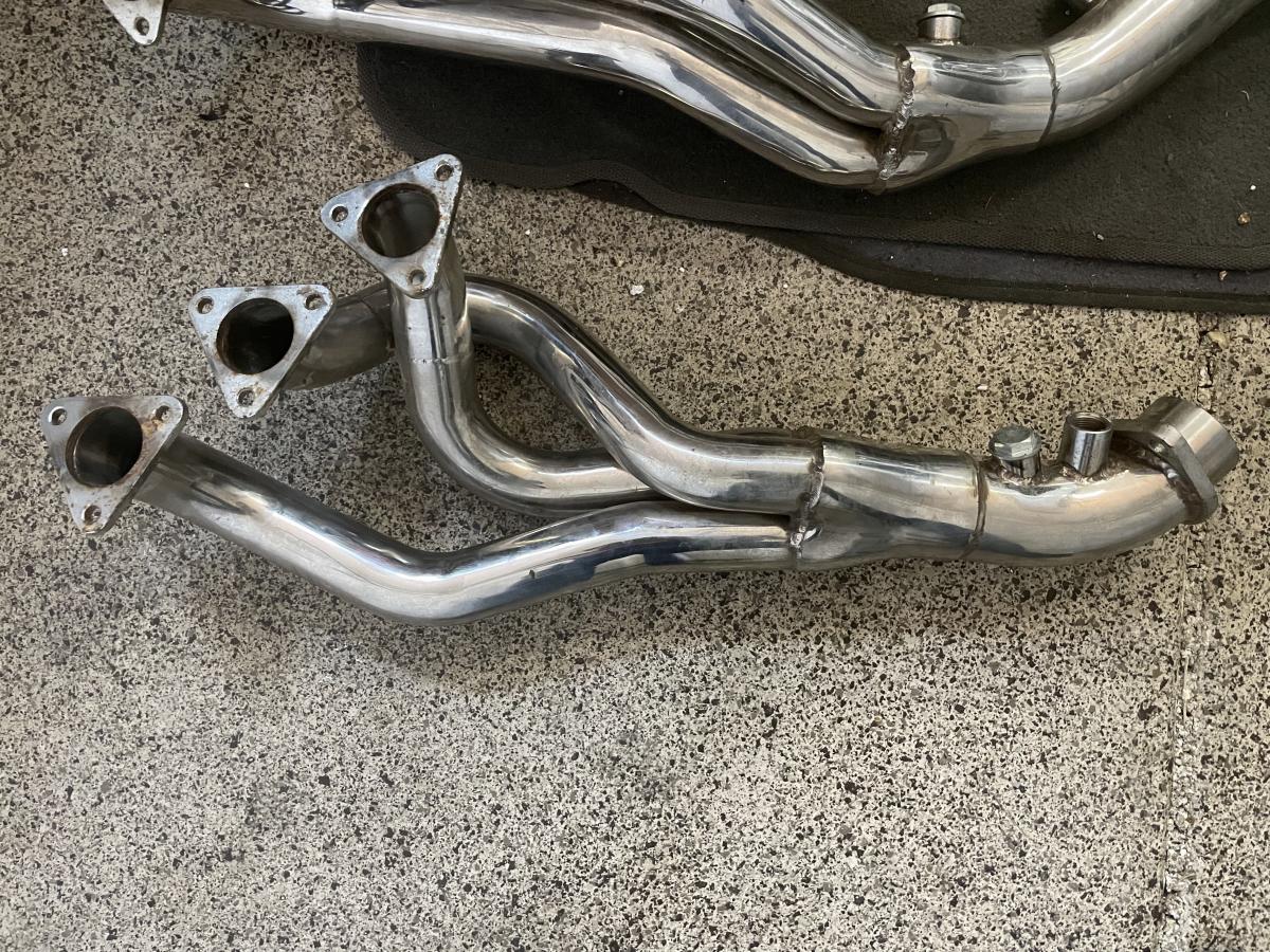

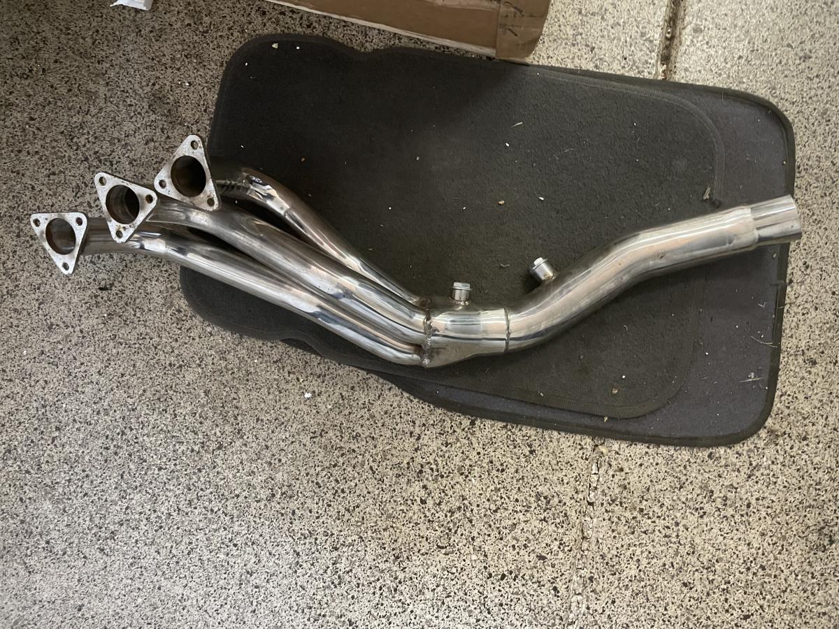

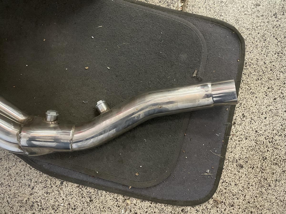

                            Is it worth installing this aftermarket header?
                              Yes because it's super cheap and will make more power than stock catted headers
                              No because it's cheap junk and will barely make more power for the amount of effort (possible headache from fitment issues) or $ spent on installing. Should wait till you get euros or supersprint imo.
