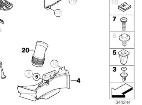

    Can anyone help me with a part number for the factory brake duct to bracket hardware? Realoem has it greyed out and ive ordered almost every other piece on this page but none match my factory hardware on the drivers side. My passenger side doesnt have the factory hardware and is currently mounted with a bolt and bunch of washers i had lying around, not ideal lol.
    Click image for larger version Name:	realoem brake duct.jpg Views:	0 Size:	24.0 KB ID:	179020

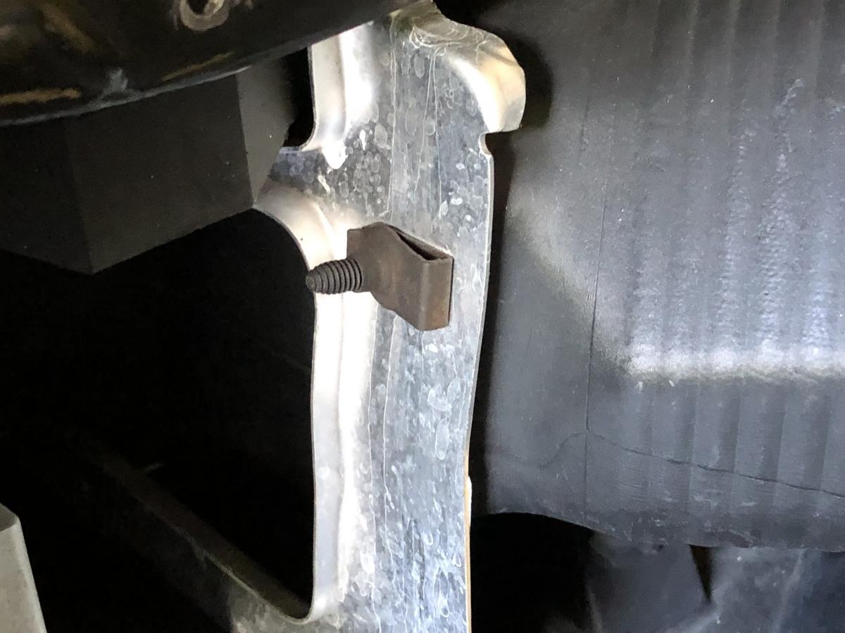

    Drivers with proper OE factory hardware

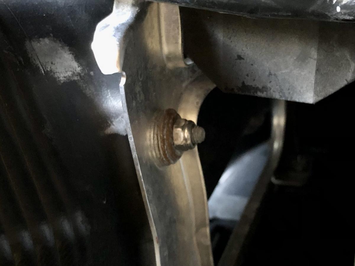

    Passengers with janky hardware lol
    Those are supposed to be plastic push pins, so driver's side isn't correct either: https://nam3forum.com/forums/forum/m...-plastic-rivet
      Originally posted by Shonky View Post
      In my experience you can't always trust the greyed out stuff for minor hardware like this. To get a part number go back and manually pick something like a 320i instead and then go to the same page and you'll often find the part number listed
      e.g. https://www.realoem.com/bmw/enUS/sho...diagId=51_3275
      (Note I tried a 330Ci first and it was disabled there too)
      You might want #17 cropped from your image
      Ah thats a good trick for realoem! Thanks for that, it would always irk me how some things would randomly be greyed out, so this is def helpful in future
      Well damn, i had a feeling of ‘watch the driverside hardware be wrong too’ especially as i recently found alot of jank from a previous owners sloppy repair job lol.
      Awesome thanks for this, looks like Casa de Mesa nailed the right part number for the proper plastic rivets!
      EDIT: Oops shouldve read through the whole thread, its actually part number 51711936929, thanks to NZ_M3!
        Hey thanks for quoting me on this one. I just edited that other post so anyone who doesn't read all the way through like you did won't order the wrong part.
