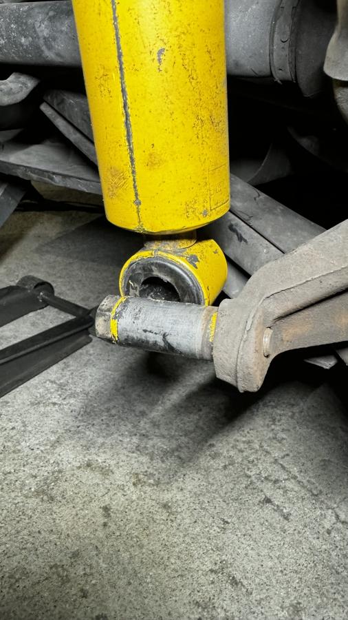

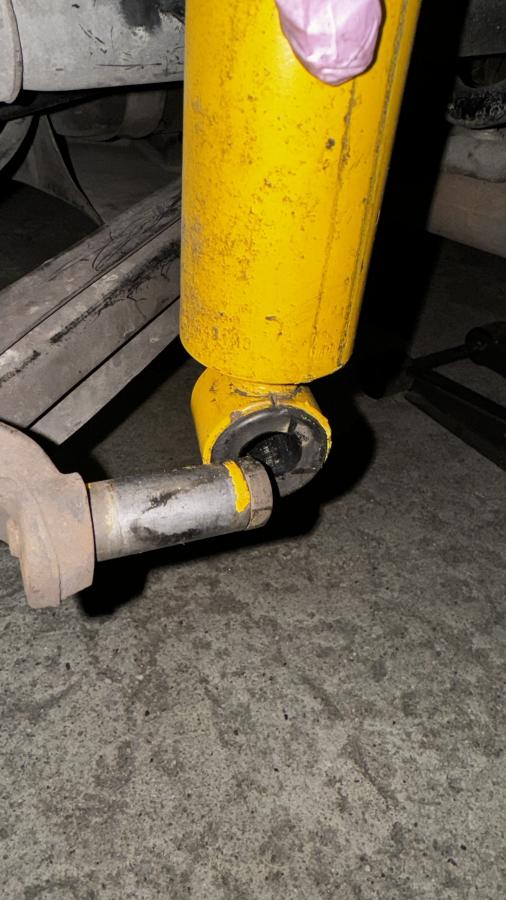

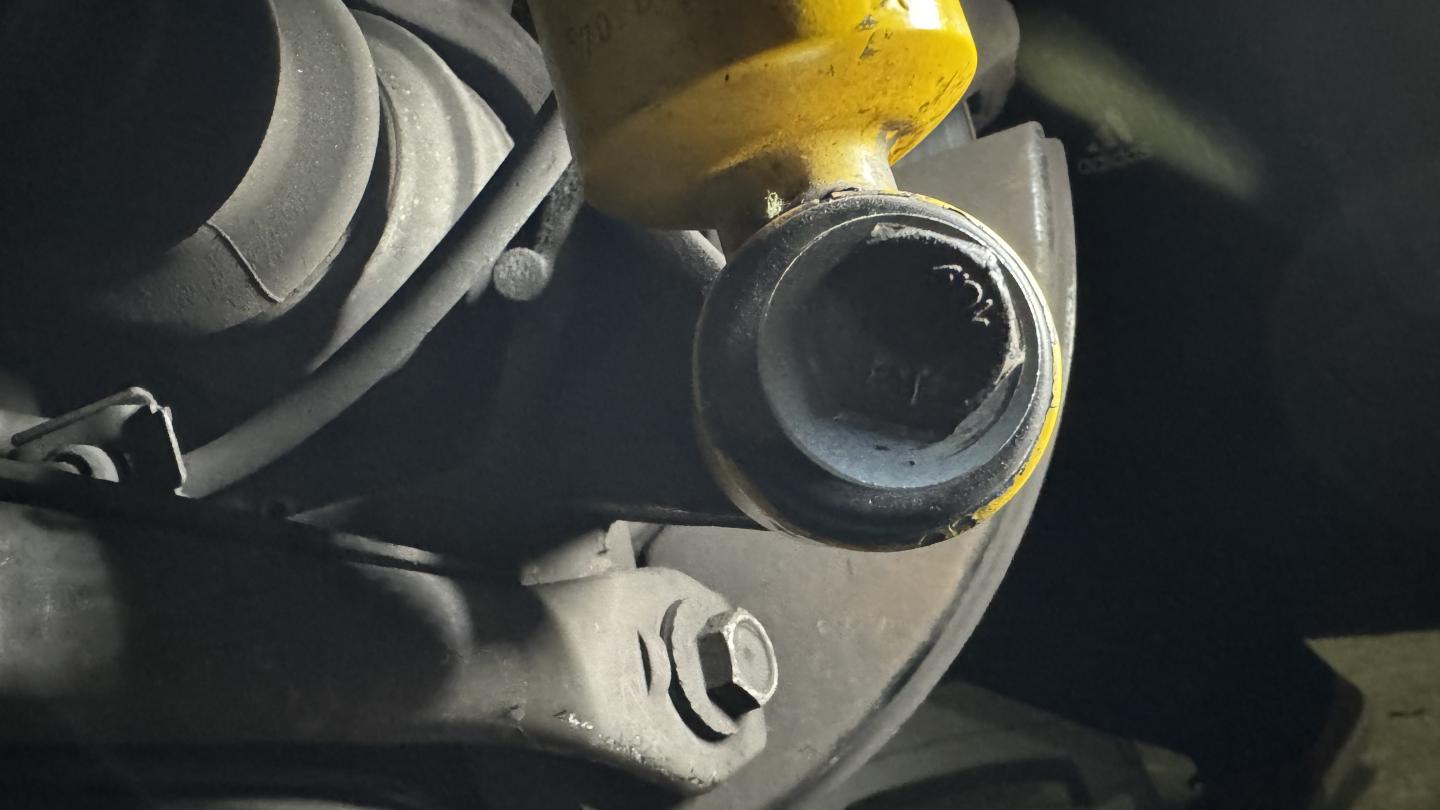

                So I bought a set of H & R coilovers used, and I’m just now finding out that I’m missing a part. Does anyone know what the little washer tube thing that goes through the bottom shock bushing is called? Click image for larger version

                  I think you just need to add a nice washer to the end of that. I don't think a new tube/sleeve will help.

                      Originally posted by gaiakai View Post
                      So I bought a set of H & R coilovers used, and I’m just now finding out that I’m missing a part. Does anyone know what the little washer tube thing that goes through the bottom shock bushing is called? Click image for larger version  Name:	IMG_5628.jpg Views:	44 Size:	71.7 KB ID:	248161
                      Click image for larger version  Name:	IMG_5629.jpg Views:	42 Size:	83.3 KB ID:	248162
                      If you look at the pictures of a new kit, they are just standard washers that limit movement of the lower bushing. Unfortunately, the rubber bushing is molded with the sleeve and yours has failed. HR (or Bilstein since it is a Bilstein damper) might warranty that damper, but they don't usually sell a new bushing separately to press in.
                      There happens to be a listing for a set of used rear dampers for the HR kit - https://www.ebay.com/itm/15585387568...CABEgIMwvD_BwE
                        Good looking out, I ended up just getting a flat washer to have that press against the bushing. I’m thinking of eventually replacing it with a fender washer for more security, but this seems to be ok so far.
                                The bushing acts like a spring and it not being attached to the sleeve anymore means that has lost its functionality. Adding a washer is not going to solve the problem, unfortunately. Also, the rear dampers need to be torqued at ride height; otherwise, the lower bushing can fail like yours has.
