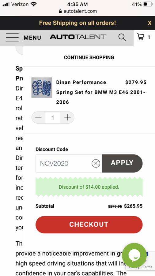

    Is Dinan still manufacturing those springs? or are they running out the stock.
    I see that they are not available from all the main on-line vendors.
    I'm looking for a firm damped ride.
    The Bilstein B8/OEM ride which was unpopular on the E36M3 is what I'm looking for.
      Cheers for the reply.
      Autotalent has them. No tax and free shipping. Use coupon code nov2020 for 5% off.
        Cheers for that.
        Getting the ride/handling to where I want it is giving me OCD
