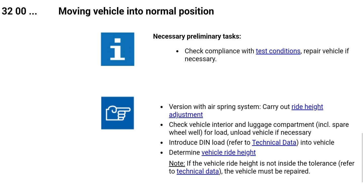

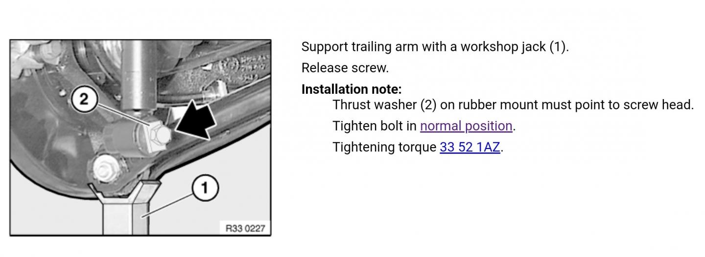

            Rear shock:
            What "normal position" means:

              Or follow the TIS specs per manufacturer recommendations

                  If the rubber bushing is tightened at full droop, it will heavily preload and twist the bushing when at ride height. If it is done at ride height, the rubber bushing will have little to no preload and can twist in its normal operating range. Front sway bar end links, outer rear lower control arm and spring perch ball joints can be tighten without the car being at ride height. On a ball joint, the inner ball is not fixed to the outer sleeve. On a rubber bushing, the inner sleeve is directly connected to the outer sleeve via rubber.
                    I understand why bushings like RTAB and inner upper/lower control arms needs to be tightened at ride height. But the amount of rubber and location of the lower shock attachment point is not going to impart any meaningful force on the suspension or be rotated enough during suspension travel to tear the rubber.
                      The size of the bushing does not matter. RTABS, upper control arm, upper spring perch and lower rear damper bushings are all the same style. Granted, the RTABs will probably fail the fastest out of the four.

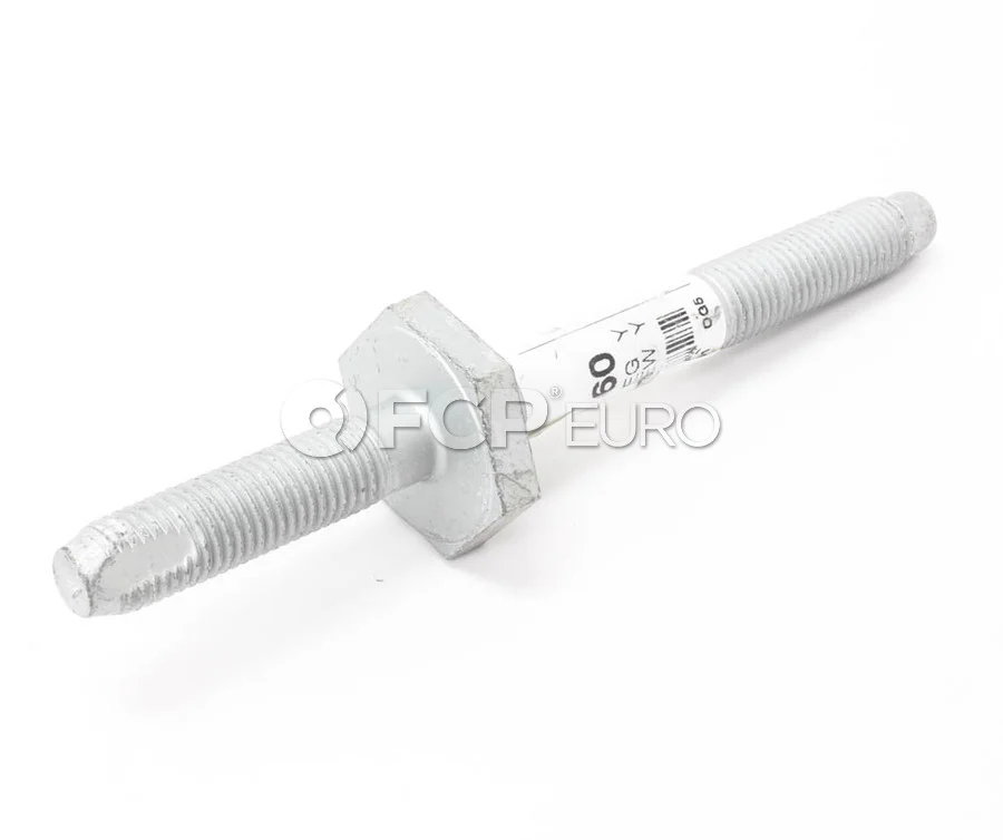

                            I’m having an annoying time getting the two front mounting bolts for the rear subframe. I believe these are 31mm(?) and of course no one has that size of anything in stock. Tried using channel locks, as the bolts come out they get progressively tighter to the point where the pliers just slip. I wonder if the previous owner in his infinite wisdom put loctite on these. I ordered a deep 31mm socket and I think I’m going to go caveman and just cut the bolt off and use the socket and a blowtorch. Unless you guys can instruct me on the correct method. I need these off asap so I can keep going on the project.
                              They might be seized or rusted up inside the chassis, you could be running into an instance where they are galling the threads on removal. Maybe try some heat and work them back and forth Cutting them flush is not a bad idea if you can replace them.

                                Thank you, yea I am going to drive them back in, heat them up, and hope they are not rusted haha. I suppose anything is possible but the car is *mostly* rust free. I think the studs were used to hold the plates in place while the epoxy dried. So I feel like the epoxy is what is making my life difficult, and thus, hoping some heat will help.
